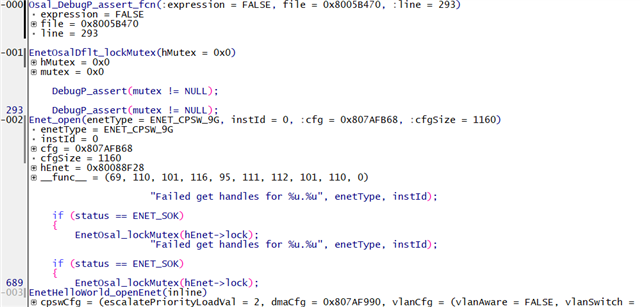

  • Is there an any example using Enet LLD which runs on MPU1_0 core. Or is it neccessary to run from MCU cores? Currently below sequence is followed for Enet initialization. Please verify this
    1. SBL board init for pinmux (CPSW2G ) MDIO pin is configured and related inits.

    3. Board init and serdes init from MPU Enet examples is removed.
    gEnetHelloWorld.boardId = ENETBOARD_SGMII_ID;
    gEnetHelloWorld.expPort = ENETBOARD_EXP_PORT_NONE;
    gEnetHelloWorld.macPort = ENET_MAC_PORT_8;
    4. Enabling of clocks and power for CPSW2G and CPSW9G is done in MPU side.
    gEnetHelloWorld.enetType = ENET_CPSW_2G;
    gEnetHelloWorld.instId = 0U;
    /* Start the clock */
    EnetAppUtils_enableClocks(gEnetHelloWorld.enetType, gEnetHelloWorld.instId);
    gEnetHelloWorld.enetType = ENET_CPSW_9G;
    gEnetHelloWorld.useSGMII = 1U;
    5. Enet init is done on MPU.
    6. Enet open is then done. (This gives an assert in Osal mutex function and that there is a flow error).
    If I skip this assert, below error is there

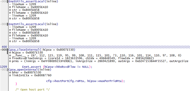

    CPSW Test
    Cpsw_openInternal: Failed to allocate RX flow via RM: -8
    Cpsw_closeInternal: : -1
    Assertion @ Line: 1209 in /home/uir1kor/ORBIX_uP/sw/ti/drv/enet/src/per/cpsw.c: hCpsw->hRxRsvdFlow != NULL
    We don't have examples supported by RTOS SDK to run on the MPU1_0 core.
    MPU cores are designed for application purposes, running HLOS such as Linux/QNX.
    We have a Native Linux driver supported by the TI SDK for network functionality.
    U-Boot also supports the CPSW2G native driver, and can be used for TFTP from U-Boot.

    CPSW Test
    As mentioned above, examples are developed only for a few cores, we need to take care of resource allocation if we want to run examples from other cores, but not on MPU cores.
