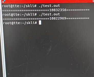

  • Based on the test code above, the result of changing the loop to 10 billion times is consistent with the result of 100 million times:
    The result of running 10 billion times at 2.0 GHz took 10.8 seconds. As shown in the figure below:
    The result of running 10 billion times at 1.2 GHz took 8.8 seconds. As shown in the figure below:
    Test code is also provided, and you can conduct verification testing on your end. Please synchronize the verification testing with us and see how to handle it.

  • How is it possible that executing 10 billion times or 100 million times would take a total of 1 us? Currently, our TI CPU cannot sit in 1 us no matter how fast it is. We seriously suspect that the gtc time obtained from your environment is abnormal. You can use the getSysTimeUsec time obtained from Linux to confirm. Additionally, during execution, you can use time./test.out to obtain the total runtime of test.out.
    Please confirm more here, otherwise communication back and forth will be too slow.

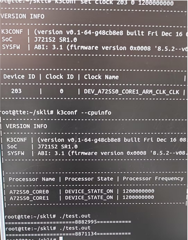

  • Add a screenshot of the 1.2HGZ runtime and include the Linux time command to track the overall runtime。
    1、100 million
    2、10 billion
  • Let's give you the binary file we have compiled, and the time is obtained using Linux

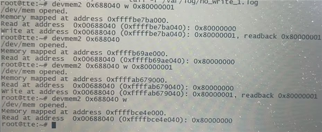

  • Hello Weiwei,
    Seems to be not using the PLL8_SS_CTRL Register bit[0]. Hence some of the frequencies were causing different behaviors:
    Once we set the bit to 0x1 using:
    devmem2 0x688040 w 0x80000001
    Then lower the frequency to 1.2GHz.
    Can you try 1.2GHz and check if the performance is as expected?

  • Our TDAVMECO test at 1.2GHZ met expectations and was consistent with the TDA4VL test at 1.2GHZ. However, TDAVMECO's 2GHz is slower than 1.2GHZ, which does not meet expectations. Our question is here (please be aware and clarify, and we will take measures to address this issue). Of course, using overclocking at 2.7GHZ for TDAVMECO also makes it faster.
    So, why is TDAVMECO's 2.0GHz slower than 1.2GHz (whether it's ECO's 1.2GHz or TDA4VL's 1.2GHz)

  • We use the k3conf command of TDA4VL to view or configure the CPU clock speed of A72 core. In addition, we found that the A72 core of TDA4ECO runs slower than the A72 core of TDA4VL, which is why we conducted these tests. Just asked the experts from TI to see where the problem lies. We also hope to address this issue on the 805 SDK version. Please be informed.

  • hi,
    1、As shown in the figure below, we found that after manually writing 1 to the register bit0 (devmem2 0x688040 w 0x8000001), the data will be altered. May I ask what the reason may be?
    2、Additionally, it has been reported that this behavior has been fixed in a higher version of the SDK. I would like to know where the bit0 register was set to 1 (such as sbl)? )Can you give us a patch for the V805 SDK?
    This bit let's the frequency to be programmed correctly.
    This was fixed in device manager firmware. Since this was fixed couple of years back we would recommend setting this in Linux.
    Keerthy
  • Hi
    setting this in Linux: so Is it more reasonable to set it in the kernel or during file system startup? Or can it all be done?
    Additionally,As shown in the figure below, we found that after manually writing 1 to the register bit0 (devmem2 0x688040 w 0x8000001), the data will be altered. May I ask what the reason may be?
    Should be good to set it before your use case starts. Can do it at the beginning of the use case.
     Can you readback and check the register?
    - Keerthy
    We have confirmed the value of the register through a read back, and also performed read and write operations on 0x688040 using devmem2. After using "devmem2 0x688040 w 0x80000001", the value of the 0x688040 register was restored to 0x80000000. Please see the image we sent below:

  • Here was what I was seeing. I was not seeing register value change back after I wrote it in Linux using devmem2.
    Thanks Takuma. That is the same behavior on the other TDA4 SoCs that I have tried in the past.
    - Keerthy
    I understand, but it did happen during the testing process. So I would like to ask TI experts where the problem may be and where the historical values will be rewritten?

  • Hi Weiwei,
    The fix is to write to the register address 0x688040 with a value of 0x80000001.
    Proper fix would be to move SDK version. But, if choosing to stay on the old SDK, then the fix is to write to that register. How to implement this write is up to developer, whether it be a write at U-Boot, Linux, kernel driver, userspace application, commandline, etc.
    I would like to make clear that the behavior observed on your system with the devmem2 command not going through is not observed at TI. Below is a log on 5.10 kernel used with v805, and using the default image from the SDK.

    In the logs, I run your test application in the following order:
    1. Run test.out with default SDK image, directly after logging in -> cost:10007115
    2. Set clock from 2.0->1.2GHz
    3. Run test.out -> cost:8338646
    4. devmem2 0x688040 w 0x80000001
    5. Run test.out -> cost:16843217
    6. Set clock back to original frequency, by changing from 1.2->2.0GHz
    7. Run test.out -> cost:10009196
    Address 0x688040 value is checked throughout to confirm the value is 0x80000001 after the devmem2 command. And, as you can see, the "cost" reports back as expected after the register write. That is, 1.2/2 = 0.6 = around 10009196/16843217 (0.594256786). Why the write is not sticking on your system is a mystery and not expected behavior. As some suggestion, you may try to write from U-Boot, kernel driver, userspace application, to see if any of the writes stick.

  • HI Takuma,
    We understand that our current test results are consistent with TI's results, provided that after writing 0x8000001 to the 0x688040 register and not rewriting it back to 0x8000001, there is no problem with this.
    But we have learned that if the register bit0 does not write 1, our TDA4VL's 1.2GHz is also running at overclocking 2.4GHz. Therefore, we want to set this register bit0 to 1 for testing. After writing bit0 to 1 through devmem2, we found that sometimes this register is inexplicably rewritten back to the default 0x80000000 (bit0 is automatically cleared). We are not sure where it will be rewritten, so we need to consult experts from TI to help us locate the problem? Provide directions that need to be investigated, etc.
  • Hi Weiwei,
    Two questions:
    1. How often does the register get written back to default value? Is it every time the write is done? Or is it like 1 or 2 times out of 20?
    2. Other than A72 core, what other core is running software on your system?
    My system runs just Linux on the A72 cores and DM on a R5F core to manage the device resource. If there are other cores running on your system, then you should try to disable them to get both of our systems as close as possible to narrow down where issue can be.
    Takuma

  • sync on the status.   Please help correct me.
    1. Customer reports the issue on VE, performance @ 2GHz < @1.2GHz, based on SDK8.5.
    2. Customer know that PLL8_SS_CTRL Register bit[0] need be set to 1 when A72 frequency set to 1.2GHz. has fix in latest SDK.
    3. A72 frequency will be overclock to 2.4GHz if PLL8_SS_CTRL Register bit[0] is not set to 1 when A72 frequency set to 1.2GHz.
    4. Customer checked there is similar issue on VL.
    5. Customer has shipped many ECUs w/ TDA4VL to CAR OEM w/ SW based on SDK8.5. They need clear solution w/ verification.
    6. Customer found new problem, PLL8_SS_CTRL Register bit[0] written back to default value sometimes in the way that they are not aware of.
    further actions:
    1. For VE, suggest to upgrade to latest Version SDK.
    2. For VL, suggest to write the bit from U-Boot, kernel driver, userspace application. any question from Customer?
    3. For VL, need Customer try to narrow down which one write back the bit in their system.
    thanks a lot!
