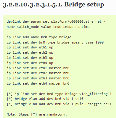

In the latest TI documentation, to setup a bridge for CPSW9G in native ethernet mode, there are some commands I don't fully understand.
3.2.2.10.3.2.3.1. CPSWng Native Ethernet — Processor SDK Linux for TDA4VM Documentation
At the end of the setup are three mandatory steps (as indicated by [*]).
[*] ip link set dev br0 type bridge vlan_filtering 1
[*] bridge vlan add dev br0 vid 1 self
[*] bridge vlan add dev br0 vid 1 pvid untagged self
Please correct me if I'm wrong. To me the documentation reads as: "you have to run every one of these commands in this exact order".
To me, the two last commands do more or less the same thing.
Add VID 1 to the bridge interface br0 (first command):
Add VID 1 to the bridge interface br0, but also set VID 1 as PVID and untag packets with VID 1 on egress (second command):
So both commands add VID 1 to br0. "pvid" and "untagged" are only options. Why do I have to run the first command first?
Why can't I just run
This command alone will add VID 1 to br0. Just as the first command does. But it will also set up the additional flags.
Further down the documentation adds some explanation to the two commands:
<---- add VLAN as a Bridge Entry
<---- add cpu port to VLAN 1
But "pvid" and "untagged" are just additional option (as stated in the man pages bridge(8) - Linux manual page)
bridge vlan { add | del } dev DEV vid VID [ tunnel_info TUNNEL_ID ] [ pvid ] [ untagged ] [ self ] [ master ]
Is TI somehow using the fact, that the second command adds "pvid" and "untagged" to the command and does something different than when these options are missing?
What is the technical explanation that both commands are needed for CPSW9G?

  • Hi Matthias,
    The bridge layer is not modified by TI. We just use hooks in this to hardware offload VLAN filtering and tagging properties.
    That means that there is no one specific order or structure to the commands. It depends on how the user configures. The behavior doesn't change from the man pages.
    I tried by commenting the command just now and there are differences in the resulting configuration. So it does seem that both commands are required and do different things.
    Tanmay
  • Hi Tanmay,
    I can see the differences in the configuration on my system as well. But I only see them on the TI hardware. The "bridge" tool has no indication that something is different.
    Running "bridge vlan show" always shows this result:
    port              vlan-id
    xf2               1 PVID Egress Untagged
                        state forwarding mcast_router 1
    xf4               1 PVID Egress Untagged
    br0               1 PVID Egress Untagged
    Only the switch ALE entries show some differences.
    If I run the lines from the documentaion:
    I get a working configuration with:
    7: Type: Inner VLAN
    Nolearn Mask = 0x0, Ingress Check = 0
    VLAN ID = 1, Registered Mask = 0x61, No Frag = 0
    Force Untagged Packet Egress = 0x61, Limit Next Header Control = 0, Unregistered Mask = 0x1, Members = 0x61
    If I ommit "bridge vlan add dev br0 vid 1 self" and only run this:
    I get a not working configuration:
    7: Type: Inner VLAN
    VLAN ID = 1, Registered Mask = 0x60, No Frag = 0
    Force Untagged Packet Egress = 0x60, Limit Next Header Control = 0, Unregistered Mask = 0x0, Members = 0x60
    However, if I slightly change the documentation example to:
    bridge vlan add dev br0 vid 1 pvid tagged self
    I again get a working configuratin with:
    7: Type: Inner VLAN
    Yes, both commands are required and do different things. But the difference is only on the TI HW.
    This seems very strange to me. I can't imagine how running these two almost identical lines is really making a difference and is always required with every Linux bridge interface. The kernel shows the correct configuration after I run "bridge vlan add dev br0 vid 1 pvid untagged self" and the software solution of the Linux bridge interface also functions correctly after only running this one line.
    I only get a working configuration with the TI hardware after I run two almost identical commands.
    To me it looks quite clearly that only the TI HW needs both commands to function and this is not a Linux bridge requirement in general. I can't find any other example with a Linux bridge interface where adding a VID requires running the almost identical command twice.
    Matthias
  • Hi Matthias,
    Not sure what is happening in  the kernel (bridge layer regarding this). But it does seems that the second command is not adding the vid to host port. This could be a bug in kernel or it could have some deliberate reasons to keep it this way for hardware bridges. Moreover, the bridge configuration also works with standard systemd networkd configuration
    In any case, there is no issue with TI switchdev layer.
    Tanmay
  • Hi Tanmay,
    So the technical reason is unclear. We just know that it's needed. It could be a bug or an unknown requirement.
    Thanks for your help regardless.
    Matthias
  • Hi Matthias,
    This is also something I agree with. So it turns out I think the two commands were not needed before kernel 5.10. So there might be some changes in kernel where this is coming from.
    Just wanted to let you know.
    Tanmay
