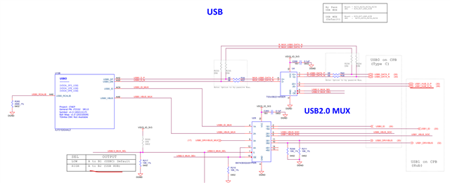

J721S2XSOMXEVM: J721S2 / J721E USB 3.1 ports only operate at USB 2.0 speed (SDK 10.01.00.04) - Processors forum - Processors - TI E2E support forums
 On J721E I was able to resolve the USB3.0 issue successfully.
Now I need to enable USB3.0 on the J721S2 platform as well.(using Processor SDK Linux 10.01.00.04)
Issue observed:
  • When connecting with a USB3.0 cable, the device is not detected at all.
  • When connecting with a USB2.0 cable, the device is detected but only enumerates as USB2.0.
Could you please let me know what steps are required, or if there are any patches/configurations needed, for J721S2 to get USB3.0 working?

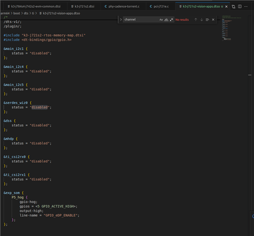

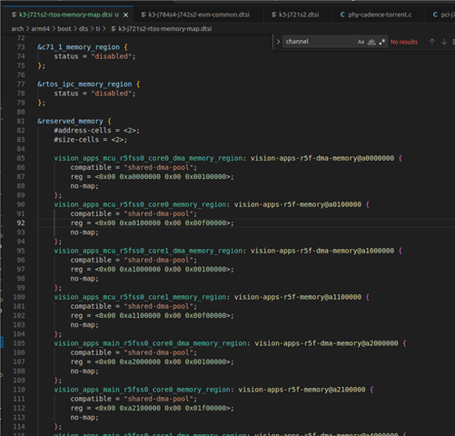

    root@j721s2-evm:~# [   20.350062] platform 6000000.usb: deferred probe pending
    [   20.355389] platform regulator-dp1-prw: deferred probe pending
    [   20.361217] platform fixedregulator-dp0-prw: deferred probe pending
    [   20.367485] platform a000000.dp-bridge: deferred probe pending
    [   20.373311] platform dp0-connector: deferred probe pending
    So the USB3.0 device is not detected at all.
    Could you please advise if additional changes are required on J721S2?

  • HI Zemiaou,
    I am attaching the dtb I have used.
    https://e2e.ti.com/cfs-file/__key/communityserver-discussions-components-files/791/6406.k3_2D00_j721s2_2D00_common_2D00_proc_2D00_board.dtb
    Gokul
  • Hi Gokul,
    Thank you for sharing the DTB file.
    I have downloaded and tested it, but I still see the same issue on my setup.
    In my case, I get the log message
    and when I run `lsusb` no devices are detected.
    What I did was directly copy the DTB into `/rootfs/boot/dts/ti/`, replacing the old file.
    Could you please let me know the exact steps you followed to compile and deploy the DTB on your setup?
    Also, do you see the same `platform 6000000.usb: deferred probe pending` log message on your board?
    Liu
  • Hi zemiaou,
    Just had a couple of questions to ask:
    • Are you using TI J721S2 EVM or is it a custom board?
    • Also have you made any other changes from the default SDK code other than the device tree changes that I have provided.
    I also just copied the dtb to the /rootfs/boot/dts/ti directory and I was not able to see the deferred probe pending messages on my side, actually.
    Gokul
  • Hi Gokul,
    • I am using the official TI J721S2 EVM, not a custom board.
    • Other than the device tree changes you provided, I have not made any other modifications to the SDK.
    only k3-j721s2-common-proc-board.dtb shows a recent date (Aug 31 2025), while all the other dtb/dtbo files still have the same timestamp (Mar 9 2018) .These 2018 timestamps are just the default ones coming from the SDK.

  • Hi Liu,
    I see that the platform 6000000.usb: deferred probe pending print has gone away from your logs. Please correct me if I am wrong.
    Also, can you remove the USB-C connection and share the output of the "lsusb -t" command in Linux.
    Gokul

  • Hi Liu,
    It seems that the SERDES pins are connected to the USB HUB?
    so maybe in the dtb, you need to change the USB_SEL_MUX to high instead of low to route the SERDES through the HUB?
  • I got to know that only the type-C supports the USB3.0 and the HUB is only USB2.0 support.
    Please ensure that the USB mux is pulled low and not high.
    Also, check on the SERDES USB assignment in the dtb are right.
    By any chance, if you flip the cable, is it detecting the USB3.0? I remember from another e2e that flipping the cable was able to detect the USB3.0. Maybe again it could be pointing to the SERDES assignment.

  • Liu,
    The other thing would be to ensure that the USB_mode_sel DIP switches are in off, off position to select the DFP mode.
  • Hi Liu,

  • Hi Shreyas,
    I would like to continue using Vision Apps.
    However, if I remove the overlay in uEnv.txt (name_overlays=ti/k3-j721s2-vision-apps.dtbo), running
    source /opt/vision_apps/vision_apps_init.sh
    fails with memory mapping errors (log/fileio carveout not available).
    root@j721s2-evm:/opt# source ./vision_apps/vision_apps_init.sh
    root@j721s2-evm:/opt#      0.000000 s: APP_LOG: ERROR: Unable to map memory @ 0xaa000000 of size 262144 bytes !!!
    APP_LOG: ERROR: Unable to map memory @ 0xae000000 of size 3288576 bytes !!!
    On the other hand, if I keep the overlay, USB3.0 only works in USB2.0 speed mode.
    How can I solve this conflict so that I can use Vision Apps with USB3.0 enabled?
    Liu
  • Liu,
    This is great to see the USB3.0 5G mode working now with the uenv.txt commented out.
    Mem map error looks like we need to allocate more memory into these memory area beyond the default.
  • Hi Liu,
    Issue is that the dtbo disables serdes_wiz node in devicetree for Linux, since without it, both A72 Linux running the USB driver, and R5F RTOS running the display driver are configuring the serdes, causing resource conflict. Software needs to be configured such that Linux only touches USB related configurations, and RTOS only touches display related configurations.
    Please apply this patch in dts to disable PCIe, DP from Linux, and enable just USB: https://gist.github.com/Siddharth-Vadapalli-at-TI/d1e38147a453538a691cc6e39024123d
    And MCU R5 core needs to configure the serdes for DP+USB multi-link configuration.
    Takuma

    • Could you please clarify what exactly should be kept from the vision-apps device tree overlay, and how this memory map information should be integrated when enabling USB and disabling PCIe/DP in Linux?
    Please refer to two files in Linux kernel.
    1: k3-j721s2-rtos-memory-map.dtsi - this is an include file that has the memory map of the remote cores. This is needed.
    2: k3-j721s2-vision-apps.dtso - this is the overlay file that includes the memory map dtsi. This disables a couple of different interfaces in Linux to give control to RTOS. serdes_wiz0 might be needed... but first just try out with no changes.
