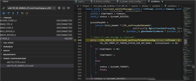

    I'm trying to test with mcu_plus_sdk_am62ax_11_01_00_16, but I'm having trouble confirming the frequency. System_Init() doesn't complete.
    The steps I took are as follows:
    1. Applying the frequency change patch and building the bootloader with mcusdkv11
      sbl_null.release.hs_fs.tiimage(created based on this thread) write to emmc.
    2. Successfully booting the c7x at 250MHz (set to 250MHz for testing)
    3. Connecting with CCSv20 - Importing the project in mcusdkv11 (helloworld)
    4. Running after building
    5. Unable to complete PowerClock_init() execution in System_init(void)
    This issue did not occur when booting with the previous version of the bootloader. The startup log displays the follow message.

    The customer tried rewriting the bootloader with the latest mcuSDKv11.01 and running make -s all PROFILE=debug, but the result did not change. When running c7x helloworld, it gets stuck waiting for a message in PowerClock_init() in void System_init(void), resulting in NG.

    Are you using emmc bootmode? If yes, Can you please try the following change?
    1.  comment out System_deinit in line 210 and line 356 respectively of mcu_plus_sdk\am62a\examples\drivers\boot\sbl_emmc_multistage(both stage 1 and stage 2)
    2. clean project and rebuild
    Shreyansh

  • Hi O.H,
    My customer and I are using the same software, but the above WARNIG message was not output in my environment. In my environment, I boot from QSPI and check the frequency (clock count) change. I believe the appearance of this WARNIG message is the cause of the problem.
    The issue is currently only seen with EMMC and SD boot mode. It will be fixed in the upcoming release.
    Is it "System_deinit()" on lines 216 and 285? The line numbers don't match, so I'm just checking to be sure.
    Sorry, my bad. Yes, line 285 in stage 2 and 216 in stage 1.
    Shreyansh
  • Hi Shreyansh,
    Thank you for your reply.
    Below is a customer comment.
    Based on your advice, I was able to change the startup frequency and perform measurements.
    Thank you.
