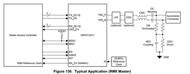

    I found out that the XI pin for KSZ8081 takes a 25MHZ clk as input but the ref_clk has no signal at all. I am not sure if the KSZ8081 has to be configured in another mode.

    My doubt is that there's something wrong regarding the REF_CLK of the KSZ8081 chip. It should output 50Mhz to the MAC chip but it is not the case for me.

  • Hi Mohamed, my 50MHz clock output is automatically configuring. It's possible to use mdio-tools to try to manually enable it.
