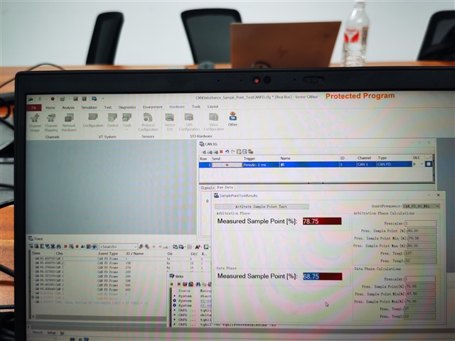

My SDK version is pdk_j721s2_08_05_00_36,Now we introduce a new CAN transceiver in MCU1_0 and configure it as follows. We found that the data domain sampling rate is too low.

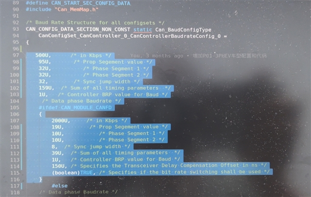

MCAL config:
Register Readback:
REG_0C=0x801c97  (MCAN_DBTP)
REG_1C=0x3e007e1f  (MCAN_NBTP)
Vector  VH6501 test result:
The target sample point of Data phase is 75%,now 68.75 is low.
Could you please help analyze why the data domain sampling rate is low?
