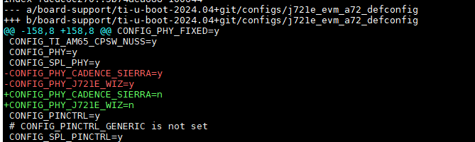

hi:
Using TDA4's CPSW9G, connecting to phy chip, link up successfully but we can't ping other devices
SDK-10.01
1. uboot
2.linux dts  k3-j721e-common-proc-board.dts

&serdes4 {
	assigned-clocks = <&serdes4 CDNS_SIERRA_PLL_CMNLC1>;
    assigned-clock-parents = <&wiz4_pll0_refclk>;
    #address-cells = <1>;
	#size-cells = <0>;
	status = "okay";
	serdes4_sgmii_link: phy@0 {
		reg = <0>;
		cdns,num-lanes = <4>;
		#phy-cells = <0>;
		cdns,phy-type = <PHY_TYPE_SGMII>;
		resets = <&serdes_wiz4 1>, <&serdes_wiz4 2>, <&serdes_wiz4 3>, <&serdes_wiz4 4>;
&cmn_refclk1 {
	clock-frequency = <100000000>;
&wiz0_pll1_refclk {
	assigned-clocks = <&wiz0_pll1_refclk>;
	assigned-clock-parents = <&cmn_refclk1>;
&wiz0_refclk_dig {
	assigned-clocks = <&wiz0_refclk_dig>;
&wiz1_pll1_refclk {
	assigned-clocks = <&wiz1_pll1_refclk>;
&wiz1_refclk_dig {
	assigned-clocks = <&wiz1_refclk_dig>;
&wiz2_pll1_refclk {
	assigned-clocks = <&wiz2_pll1_refclk>;
&wiz2_refclk_dig {
	assigned-clocks = <&wiz2_refclk_dig>;
&serdes0 {
	assigned-clocks = <&serdes0 CDNS_SIERRA_PLL_CMNLC>;
	assigned-clock-parents = <&wiz0_pll1_refclk>;
	serdes0_pcie_link: phy@0 {
		reg = <0>;
		cdns,num-lanes = <1>;
		#phy-cells = <0>;
		cdns,phy-type = <PHY_TYPE_PCIE>;
		resets = <&serdes_wiz0 1>;
&serdes1 {
	assigned-clocks = <&serdes1 CDNS_SIERRA_PLL_CMNLC>;
	assigned-clock-parents = <&wiz1_pll1_refclk>;
	status = "disabled"; //kfl
	serdes1_pcie_link: phy@0 {
		reg = <0>;
		cdns,num-lanes = <2>;
		#phy-cells = <0>;
		resets = <&serdes_wiz1 1>, <&serdes_wiz1 2>;
&serdes2 {
	assigned-clocks = <&serdes2 CDNS_SIERRA_PLL_CMNLC>;
	assigned-clock-parents = <&wiz2_pll0_refclk>;
	serdes2_pcie_link: phy@0 {
		reg = <0>;
		#phy-cells = <0>;
		resets = <&serdes_wiz2 1>, <&serdes_wiz2 2>;
&serdes4 {
	torrent_phy_dp: phy@0 {
		reg = <0>;
		resets = <&serdes_wiz4 1>;
		cdns,phy-type = <PHY_TYPE_DP>;
		cdns,max-bit-rate = <2700>;
		#phy-cells = <0>;
&mhdp {
	phys = <&torrent_phy_dp>;
	phy-names = "dpphy";
	pinctrl-names = "default";
	pinctrl-0 = <&dp0_pins_default>;
&pcie0_rc {
	status = "okay";
	reset-gpios = <&exp1 6 GPIO_ACTIVE_HIGH>;
	phys = <&serdes0_pcie_link>;
	phy-names = "pcie-phy";
	num-lanes = <1>;
&pcie1_rc {
	status = "okay";
	reset-gpios = <&exp1 2 GPIO_ACTIVE_HIGH>;
	phys = <&serdes1_pcie_link>;
	num-lanes = <2>;
&pcie2_rc {
	status = "okay";
	reset-gpios = <&exp2 20 GPIO_ACTIVE_HIGH>;
	phys = <&serdes2_pcie_link>;
	num-lanes = <2>;
3. k3-j721e-main.dtsi
serdes_wiz4: wiz@5050000 {
	//compatible = "ti,am64-wiz-10g";
	compatible = "ti,j721e-wiz-10g";
	#size-cells = <1>;
	power-domains = <&k3_pds 297 TI_SCI_PD_EXCLUSIVE>;
	clocks = <&k3_clks 297 1>, <&k3_clks 297 9>, <&cmn_refclk>;
	clock-names = "fck", "core_ref_clk", "ext_ref_clk";
	assigned-clocks = <&k3_clks 297 9>;
	assigned-clock-parents = <&k3_clks 297 13>;//10
	//assigned-clock-rates = <19200000>;
	num-lanes = <4>;
	#reset-cells = <1>;
	#clock-cells = <1>;
	ranges = <0x05050000 0x00 0x05050000 0x010000>,
		<0x0a030a00 0x00 0x0a030a00 0x40>;
	wiz4_pll0_refclk: pll0-refclk {
		clocks = <&k3_clks 297 9>, <&cmn_refclk>;
		clock-output-names = "wiz4_pll0_refclk";
		#clock-cells = <0>;
		assigned-clocks = <&wiz4_pll0_refclk>;
		assigned-clock-parents = <&k3_clks 297 9>;
	wiz4_pll1_refclk: pll1-refclk {
		clock-output-names = "wiz4_pll1_refclk";
		#clock-cells = <0>;
		assigned-clocks = <&wiz4_pll1_refclk>;
	wiz4_refclk_dig: refclk-dig {
		clock-output-names = "wiz4_refclk_dig";
		#clock-cells = <0>;
		assigned-clocks = <&wiz4_refclk_dig>;
	wiz4_cmn_refclk_dig_div: cmn-refclk-dig-div {
		#clock-cells = <0>;
	wiz4_cmn_refclk1_dig_div: cmn-refclk1-dig-div {
		#clock-cells = <0>;
	serdes4: serdes@5050000 {
		 * Note: we also map DPTX PHY registers as the Torrent
		 * needs to manage those.
		compatible = "ti,j721e-serdes-10g";
		reg = <0x05050000 0x010000>,
		      <0x0a030a00 0x40>; /* DPTX PHY */
		reg-names = "torrent_phy", "dptx_phy";
		resets = <&serdes_wiz4 0>;
		reset-names = "torrent_reset";
	//	clocks = <&serdes_wiz4 TI_WIZ_PLL0_REFCLK>;
	    clocks = <&wiz4_pll0_refclk>; //pll1
		clock-names = "refclk";
	/*	assigned-clocks = <&serdes_wiz4 TI_WIZ_PLL0_REFCLK>,
				  <&serdes_wiz4 TI_WIZ_PLL1_REFCLK>,
				  <&serdes_wiz4 TI_WIZ_REFCLK_DIG>;
		assigned-clock-parents = <&k3_clks 297 9>,
					 <&k3_clks 297 9>,
					 <&k3_clks 297 9>;
		#size-cells = <0>;
4.remove j7-main-r5f0_0-fw
5. remove uenv.txt  overlays
6. ethtool eth show link
root@j721e-evm:/home/weston/scripts# ethtool eth6
Settings for eth6:
        Supported ports: [ TP    MII ]
        Supported link modes:   1000baseT/Full
        Supported pause frame use: Symmetric
        Supports auto-negotiation: No
        Supported FEC modes: Not reported
        Advertised link modes:  Not reported
        Advertised pause frame use: Symmetric
        Advertised auto-negotiation: No
        Advertised FEC modes: Not reported
        Speed: 1000Mb/s
        Duplex: Full
        Auto-negotiation: off
        Port: Twisted Pair
        PHYAD: 10
        Transceiver: external
        MDI-X: Unknown
        Supports Wake-on: d
        Wake-on: d
        Current message level: 0x000020f7 (8439)
                               drv probe link ifdown ifup rx_err tx_err hw
        Link detected: yes
7. k3conf dump clock 297
root@j721e-evm:~# k3conf dump clock 297
| VERSION INFO                                                                 |
| K3CONF | (version 0.3-nogit built Thu Jul 25 14:13:02 UTC 2024)              |
| SoC    | J721E SR1.1                                                         |
| SYSFW  | ABI: 4.0 (firmware version 0x000a '10.1.6--v10.01.06 (Fiery Fox))') |
| Device ID | Clock ID | Clock Name                                                            | Status              | Clock Frequency |
|   297     |     0    | DEV_SERDES_10G0_IP1_LN3_TXCLK                                         | CLK_STATE_NOT_READY | 0               |
|   297     |     1    | DEV_SERDES_10G0_CLK                                                   | CLK_STATE_READY     | 125000000       |
|   297     |     2    | DEV_SERDES_10G0_IP3_LN2_TXCLK                                         | CLK_STATE_READY     | 0               |
|   297     |     3    | DEV_SERDES_10G0_IP1_LN2_TXCLK                                         | CLK_STATE_NOT_READY | 0               |
|   297     |     4    | DEV_SERDES_10G0_IP1_LN0_TXCLK                                         | CLK_STATE_NOT_READY | 0               |
|   297     |     5    | DEV_SERDES_10G0_IP3_LN1_TXCLK                                         | CLK_STATE_READY     | 0               |
|   297     |     6    | DEV_SERDES_10G0_IP3_LN3_TXCLK                                         | CLK_STATE_READY     | 0               |
|   297     |     7    | DEV_SERDES_10G0_IP3_LN0_TXCLK                                         | CLK_STATE_READY     | 0               |
|   297     |     8    | DEV_SERDES_10G0_IP1_LN1_TXCLK                                         | CLK_STATE_NOT_READY | 0               |
|   297     |     9    | DEV_SERDES_10G0_CORE_REF_CLK                                          | CLK_STATE_READY     | 100000000       |
|   297     |    10    | DEV_SERDES_10G0_CORE_REF_CLK_PARENT_GLUELOGIC_HFOSC0_CLKOUT           | CLK_STATE_READY     | 19200000        |
|   297     |    11    | DEV_SERDES_10G0_CORE_REF_CLK_PARENT_BOARD_0_HFOSC1_CLK_OUT            | CLK_STATE_READY     | 0               |
|   297     |    12    | DEV_SERDES_10G0_CORE_REF_CLK_PARENT_HSDIV4_16FFT_MAIN_3_HSDIVOUT4_CLK | CLK_STATE_READY     | 153846153       |
|   297     |    13    | DEV_SERDES_10G0_CORE_REF_CLK_PARENT_HSDIV4_16FFT_MAIN_2_HSDIVOUT4_CLK | CLK_STATE_READY     | 100000000       |
|   297     |    14    | DEV_SERDES_10G0_IP1_LN1_REFCLK                                        | CLK_STATE_READY     | 0               |
|   297     |    15    | DEV_SERDES_10G0_IP1_LN2_RXCLK                                         | CLK_STATE_READY     | 0               |
|   297     |    16    | DEV_SERDES_10G0_IP3_LN1_TXFCLK                                        | CLK_STATE_READY     | 0               |
|   297     |    17    | DEV_SERDES_10G0_IP1_LN0_RXFCLK                                        | CLK_STATE_READY     | 0               |
|   297     |    18    | DEV_SERDES_10G0_IP1_LN3_RXCLK                                         | CLK_STATE_READY     | 0               |
|   297     |    19    | DEV_SERDES_10G0_IP3_LN3_RXCLK                                         | CLK_STATE_READY     | 0               |
|   297     |    20    | DEV_SERDES_10G0_IP3_LN1_TXMCLK                                        | CLK_STATE_READY     | 0               |
|   297     |    21    | DEV_SERDES_10G0_IP3_LN3_RXFCLK                                        | CLK_STATE_READY     | 0               |
|   297     |    22    | DEV_SERDES_10G0_IP3_LN3_REFCLK                                        | CLK_STATE_READY     | 0               |
|   297     |    23    | DEV_SERDES_10G0_IP3_LN2_RXCLK                                         | CLK_STATE_READY     | 0               |
|   297     |    24    | DEV_SERDES_10G0_IP1_LN0_TXFCLK                                        | CLK_STATE_READY     | 0               |
|   297     |    25    | DEV_SERDES_10G0_IP3_LN3_TXMCLK                                        | CLK_STATE_READY     | 0               |
|   297     |    26    | DEV_SERDES_10G0_IP3_LN1_RXFCLK                                        | CLK_STATE_READY     | 0               |
|   297     |    27    | DEV_SERDES_10G0_IP3_LN0_RXFCLK                                        | CLK_STATE_READY     | 0               |
|   297     |    28    | DEV_SERDES_10G0_IP1_LN1_TXMCLK                                        | CLK_STATE_READY     | 0               |
|   297     |    29    | DEV_SERDES_10G0_IP1_LN1_RXFCLK                                        | CLK_STATE_READY     | 0               |
|   297     |    30    | DEV_SERDES_10G0_IP3_LN3_TXFCLK                                        | CLK_STATE_READY     | 0               |
|   297     |    31    | DEV_SERDES_10G0_IP1_LN3_TXFCLK                                        | CLK_STATE_READY     | 0               |
|   297     |    32    | DEV_SERDES_10G0_IP1_LN3_TXMCLK                                        | CLK_STATE_READY     | 0               |
|   297     |    33    | DEV_SERDES_10G0_IP3_LN1_REFCLK                                        | CLK_STATE_READY     | 0               |
|   297     |    34    | DEV_SERDES_10G0_IP3_LN0_REFCLK                                        | CLK_STATE_READY     | 0               |
|   297     |    35    | DEV_SERDES_10G0_IP1_LN3_REFCLK                                        | CLK_STATE_READY     | 0               |
|   297     |    36    | DEV_SERDES_10G0_IP3_LN0_RXCLK                                         | CLK_STATE_READY     | 0               |
|   297     |    37    | DEV_SERDES_10G0_IP3_LN2_REFCLK                                        | CLK_STATE_READY     | 0               |
|   297     |    38    | DEV_SERDES_10G0_IP1_LN0_RXCLK                                         | CLK_STATE_READY     | 0               |
|   297     |    39    | DEV_SERDES_10G0_IP1_LN0_REFCLK                                        | CLK_STATE_READY     | 0               |
|   297     |    40    | DEV_SERDES_10G0_IP1_LN2_RXFCLK                                        | CLK_STATE_READY     | 0               |
|   297     |    41    | DEV_SERDES_10G0_IP1_LN1_TXFCLK                                        | CLK_STATE_READY     | 0               |
|   297     |    42    | DEV_SERDES_10G0_IP3_LN0_TXFCLK                                        | CLK_STATE_READY     | 0               |
|   297     |    43    | DEV_SERDES_10G0_REF_OUT_CLK                                           | CLK_STATE_READY     | 0               |
|   297     |    44    | DEV_SERDES_10G0_IP3_LN1_RXCLK                                         | CLK_STATE_READY     | 0               |
|   297     |    45    | DEV_SERDES_10G0_IP1_LN2_TXFCLK                                        | CLK_STATE_READY     | 0               |
|   297     |    46    | DEV_SERDES_10G0_IP1_LN0_TXMCLK                                        | CLK_STATE_READY     | 0               |
|   297     |    47    | DEV_SERDES_10G0_IP3_LN2_RXFCLK                                        | CLK_STATE_READY     | 0               |
|   297     |    48    | DEV_SERDES_10G0_IP1_LN2_TXMCLK                                        | CLK_STATE_READY     | 0               |
|   297     |    49    | DEV_SERDES_10G0_IP3_LN2_TXMCLK                                        | CLK_STATE_READY     | 0               |
|   297     |    50    | DEV_SERDES_10G0_IP1_LN2_REFCLK                                        | CLK_STATE_READY     | 0               |
|   297     |    51    | DEV_SERDES_10G0_IP3_LN2_TXFCLK                                        | CLK_STATE_READY     | 0               |
|   297     |    52    | DEV_SERDES_10G0_IP3_LN0_TXMCLK                                        | CLK_STATE_READY     | 0               |
|   297     |    53    | DEV_SERDES_10G0_IP1_LN3_RXFCLK                                        | CLK_STATE_READY     | 0               |
|   297     |    54    | DEV_SERDES_10G0_IP1_LN1_RXCLK                                         | CLK_STATE_READY     | 0               |
8. port5-port8  sgmii not link, and no auto negotiation no pll lock
root@j721e-evm:/home/weston/scripts# ./j7_devmem2_cpsw9g_check_status.sh
    Platform: J7 TDA4VM
    Command:  k3conf
MDIO_ALIVE_REG (0x0c000f08) = 0x00000000
MDIO_LINK_REG (0x0c000f0c) = 0x00000000
please input your port: 1-8 5
CTRLMMR_ENET 5 CTRL (0x00104054) = 0x00000003
        PORT_MODE_SEL          : 3h SGMII
        RGMII_ID_MODE          : 0h Internal Transmit Desaly
CPSW SS RGMII 5 STATUS (0x0c000040) = 0x00000000
        FULLDUPLEX           : 0h Half duplex
        SPEED                : 0h 10Mbps
        LINK                 : 0h Links is down
CPSW_SS_STATUS_SGMII_LINK_REG (0x0c000078) = 0x00000000
        SGMII1_LINK          : 0h No
CPSW_SS_SGMII_CONTROL_REG_ 5 (0x0c000510) = 0x00000000
        TEST_PATTERN_EN      : 0h operation
        MASTER               : 0h Slave Mode
        LOOPBACK             : 0h Not in internal loopback mode
        MR_NP_LOADED         : 0h --------
        FAST_LINK_TIMER      : 0h link timer 10ms in FIBER mode and 1.6ms in SGMII mode
        MA_AN_RESTART        : 0h Write 1h and tehn 0h to this bit caused the auto negotiation
        MR_AN_ENABLE         : 0h wirte 1 to this bit enbales the auto negotiation progess
CPSW_SS_SGMII_STATUS_REG_ 5 (0x0c000514) = 0x00000000
        LOCK                  : 0h SEDES PLL isn't locked
        MR_AN_COMPLETE        : 0h no AUTO Negotiation is not complete
        AN_EEROR              : 0h no negotiation error
        LINK                  : 0h link is not up
9. 0x505E000 : 0x000C0000
root@j721e-evm:/home/weston/scripts# devmem2 0x505E000
/dev/mem opened.
Memory mapped at address 0xffff8d102000.
Read at address 0x0505E000 (0xffff8d102000): 0x000C0000
    You should use phy-mode property as "sgmii" instead "sgmii-mode" as CPSW driver.
    - phy-names = "portmode", "serdes-phy";
    + phy-names = "portmode", "serdes";
    Can you please check with above configuration?
    Sudheer
  • hi:
    according your advise
    &cpsw0_port5 {
    	status = "okay";
    	phy-handle = <&cpsw9g_phy0>;
    	phy-mode = "sgmii";
    	mac-address = [00 00 00 00 00 00];
    	phys = <&cpsw0_phy_gmii_sel 5>,<&serdes4_sgmii_link>;

    It seems like the dependent module of CPSW was not loaded. It might be a SerDes.
    Can you please share the whole log?
    Sudheer

    If you look at the logs, the SerDes driver probe failed due to some clock cells not being found.
    [ 5.070558] pca953x: probe of 2-0020 failed with error -121
    [ 5.080404] OF: /bus@100000/wiz@5050000/serdes@5050000: could not get #clock-cells for /bus@100000/wiz@5050000/serdes@5050000
    [ 5.091728] cdns-torrent-phy: probe of 5050000.serdes failed with error -22
    Please check the SerDes configuration once.

    1. Thank you very much for reminding me.
      I made a mistake. The phy address of port5-port8 is wrong. Now, after correction, port5-port8 can  ping up;
    Thank you for correcting and updating the ping working on Port-5-Port-8 from SerDes4.
    2. There is still a problem. port3 uses the rgmii interface. k3-j721e-common-proc-board.dts  as as follows,
    I would request you to create a new thread for RGMII related discussion.
    Will close this thread, as SerDes4 Port-5-Port-8 issue is resolved.
