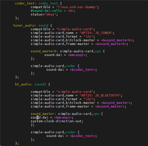

We are using the TI processor SDK ti-processor-sdk-linux-am62xx-evm-11.00.09.04. We are customizing the BSP Audio configuration for our custom hardware.
From the below post, we have configured our DTS.
https://e2e.ti.com/support/processors-group/processors/f/processors-forum/1540988/sk-am62-lp-audio-mcasp-configuring-external-clock-for-mcasp/5951326?tisearch=e2e-sitesearch&keymatch=%2520user%253A620861#
Below are snippets:
The above are the DTS configuration for Tuner and Bluetooth PCM channel. We want to know whether the configuration is proper for the tuner?. SInce our Audio tuner is driving the clock, whether we need to configure it as a master?. If so, how we can configure it?
Please provide your inputs on the same>
Thanks in advance
