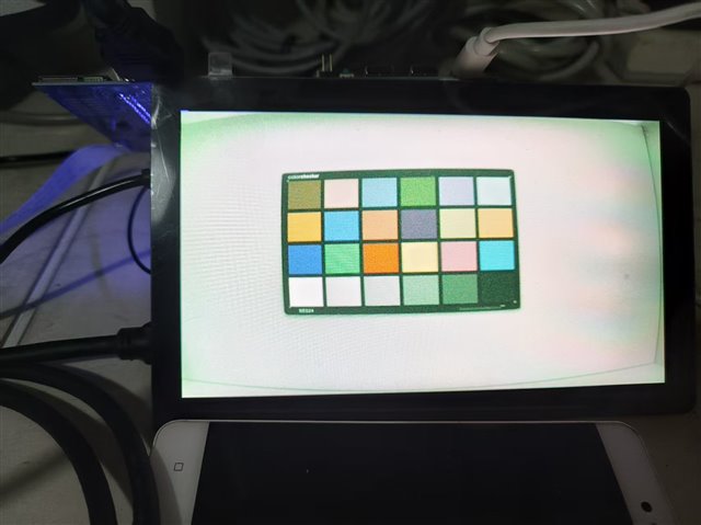

After apply  wdr bin file , Image tint is greenish,

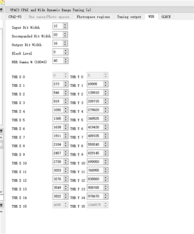

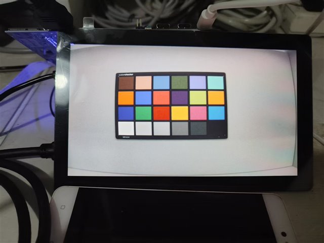

Here are my pic
1:Apply BLC
2:Apply WDR
According to the manual,If the black level is specified here, it must be set to 0 in <sensor_name>_viss_blc.xml.
Otherwise it will result in DC subtraction done twice.
So I set 63 to xml file and set 0 here
Maybe it's a problem with the WDR XML file?
Or a problem with the 2A algorithm?
