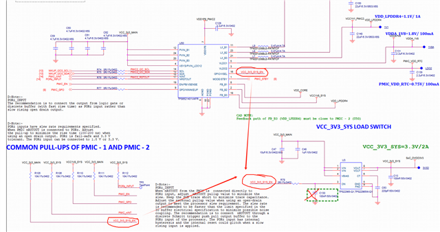

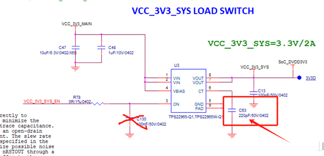

The design uses AM62L32 + LPDDR4 + eMMC. The PMIC is a PTPS6521401VAFR (which we received).

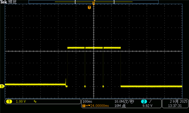

However, after the board is powered on, the PMIC's IO that controls the 3.3V load switch does not enable the EN (enable) pin of the load switch.
The waveform is as follows:
Could you help analyze what might be causing this issue?
