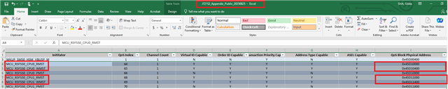

    for example,
    May I know where is the register name (address) for QOS_R5FSS0_CORE0_MEM_RD in TRM?
    Because I try to re-map this define between patch code & TRM (spruj28f), but I don not find right context
    we try to modify this patch for QOS_MCUSS_R5.
    Thank You.
    Gibbs

  • Also for MCU R5F, they are available at
    #define QOS_MCU_R5FSS0_CORE0_MEM_RD 0x45d10000
    #define QOS_MCU_R5FSS0_CORE0_MEM_RD_NUM_J_CH 1
    #define QOS_MCU_R5FSS0_CORE0_MEM_RD_NUM_I_CH 1
    #define QOS_MCU_R5FSS0_CORE0_MEM_RD_CBASS_GRP_MAP1(j) (QOS_MCU_R5FSS0_CORE0_MEM_RD + 0x0 + (j) * 8)
    #define QOS_MCU_R5FSS0_CORE0_MEM_RD_CBASS_GRP_MAP2(j) (QOS_MCU_R5FSS0_CORE0_MEM_RD + 0x4 + (j) * 8)
    #define QOS_MCU_R5FSS0_CORE0_MEM_RD_CBASS_MAP(i) (QOS_MCU_R5FSS0_CORE0_MEM_RD + 0x100 + (i) * 4)
    Brijesh
  • Hello, Brijesh
    Thanks you replies.
    I think patch code should be like as below, Could you help me double check it for "red mark ones"?
    Thank You Very Much
    Gibbs
