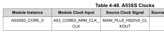

Let me use the first entry in p100m_revc_dump_clocks.xlsx as the example to explain:
Device ID: 135
Clock ID: 0
Clock Name: DEV_A53SS0_CORE_0_A53_CORE0_ARM_CLK_CLK
This is the input clock to A53 Core0, which is listed in TRM Table 4-48:
This table also shows the source of this clock is "MAIN_PLL8_HSDIV0_CLKOUT", which is shown in Figure 6-36:
