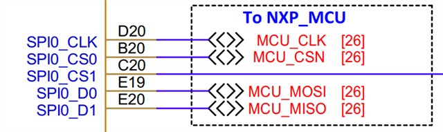

TDA4VEN-Q1: How to add a spi0 device
Part Number: TDA4VEN-Q1
Other Parts Discussed in Thread: TDA4VM
1.This SPI port is currently in use
How to configure SPI0_D0 for MIS0, SPI0_D1 for MOSI.
2. How to add and set the slave mode on dts

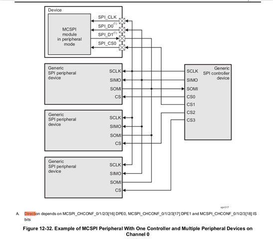

    Please reference this FAQ:  [FAQ] J722SXH01EVM: How to enable McSPI on the 40 pin user expansion header for the J722SXH01EVM?
    FAQ does not use Main SPI0, but it can be used as reference for what changes are needed to enable McSPI in general. As another reference, FAQ also has a link to application note that has more details and still relevant, but using TDA4VM.

    &main_pmx0 {
    	main_spi0_pins_default: main-spi0-pins-default {
    		pinctrl-single,pins = <
    			J722S_IOPAD(0x01bc, PIN_INPUT, 0) /* (D20) SPI0_CLK */
    			J722S_IOPAD(0x01b4, PIN_INPUT, 0) /* (B20) SPI0_CS0 */
    			J722S_IOPAD(0x01c0, PIN_INPUT, 0) /* (E19) SPI0_D0 */
    			J722S_IOPAD(0x01c4, PIN_INPUT, 0) /* (E20) SPI0_D1 */

    Is the direction set like this:
    ti,pindir-d0-in-d1-out;
    Cesar

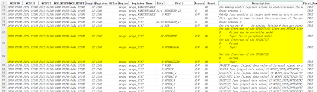

    but why is the value read from this register 0x20100124  equal to 0x0
    Regard,
    Cesar
  • Hi Cesar,
    That looks like reset values. Can you run "ls -l /sys/class/spi*" and share logs?

    root@j722s-evm:~# devmem2 0x20100124
    /dev/mem opened.
    Memory mapped at address 0xffff94e4a000.
    Read at address  0x20100124 (0xffff94e4a124): 0x00000000
    Regard,
    Cesar
  • Hi Cesar,
    SPI looks to be enumerated.
    As for the mcspi_syst register, I tried looking into our driver and TRM. Looks like driver does not program the "OMAP2_MCSPI_SYST" register. And direction is controlled by MCSPI_CHCONF registers which are written in the spi-omap2-mcspi.c driver.
    In any case, does SPI communication work now that spi_slave and spidev are both registered?
    Takuma
