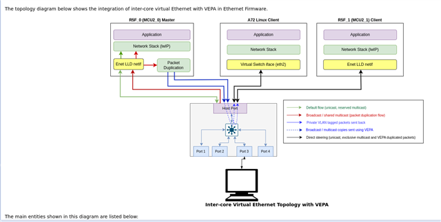

    Would you like to have a native Linux driver for the CPSW9G or ETHFW model application?
    By default, the ETHFW application runs on the MCU2_0 core. In this case, Linux has a client driver with virtual network interfaces as a virtual switch and a virtual MAC-only interface.
    Please refer to the ETHFW User Guide for more details.
    https://software-dl.ti.com/jacinto7/esd/processor-sdk-rtos-j784s4/latest/exports/docs/ethfw/docs/user_guide/ethfw_c_ug_top.html#ethfw_j784s4_port_cfg
    If you would like to run a Native Linux driver, please refer to the FAQ to enable the Native Linux driver for CPSW9G.
    [FAQ] How do I bring/brought up Ethernet interfaces for Main Domain CPSWnG in Linux from SDK Version 9.0 and above?

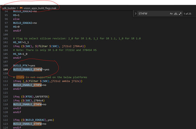

    Earlier issue might be due to vision apps loading ETHFW application on MCU2_0 core and wchihc enables Quad ports.
    Is there any way I can use the exp eth and vision_app at the same time ?
    If you would like to run vision apps and use Quad ports from Linux, you need to disable ETHFW from vision apps build and rebuild the vision applications.
    Please refer to below, for disabling ETHFW from vision apps.
    https://software-dl.ti.com/jacinto7/esd/processor-sdk-rtos-jacinto7/07_00_00_11/exports/docs/vision_apps/docs/user_guide/ETHFW_DEMOS.html#ETHFW_HOWTO_DISABLE

    You can find the ETHFW build flag from below.
    You can find the details from SDK Documentation corresponding to SDK 10.0.
    https://software-dl.ti.com/jacinto7/esd/processor-sdk-rtos-j784s4/10_00_00_05/exports/docs/vision_apps/docs/user_guide/ETHFW_DEMOS.html#ETHFW_HOWTO_DISABLE

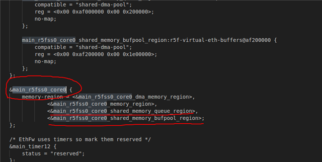

  • #include "k3-j784s4-rtos-memory-map.dtsi"
    &main_r5fss0_core0_shared_memory_queue_region {
    status = "disabled";
    &main_r5fss0_core0_shared_memory_bufpool_region {
    If I add this in order to use vision app it will cause ping failure(while can ifconfig list  devices)
    Is there any possible causes for this problem?
    XXXXXXXXXXXXXXXXXXXXXXXXXXXXXXXXXXXXXXXXXXXXXXXXXX
    You don't need to remove the ETHFW overlay. Just disable the ETHFW build flag and rebuild vision apps.

  • https://e2e.ti.com/support/processors-group/processors/f/processors-forum/1316650/j721exsomxevm-quad-ethernet-ports-not-working---ports-detected-but-ping-not-working/5009113?tisearch=e2e-sitesearch&keymatch=quad-port-eth#
    According this threads,"When you are using above overlay, you should not use EthFw which is mapped to MCU2_0 (main_r5f0_0) softlink with ethfw binary.
    If you are using vision apps, vision binary of mcu2_0 is mapped (it also has ethfw)."
    It is really possible to use ETH EXP and vision_app at the same time?
    Yes, definitely.
    The only thing you need to take care of is disabling ETHFW from vision apps, as described above, as you can't CPSW from both Linux and ETHFW at the same time.
    Have you tried disabling ETHFW from the Vision application and rebuilding the Vision Apps by following the Vision Apps User Guide?
    Sudheer
  • BUILD PTK2=yes
    -BUILD ENABLE ETHFW?=yes
    +BUILD ENABLE_ETHFW?=no
    Then i run  "make vision_apps_scrub"
    And update whole /usr and /opt
    Vision apps scrub will not build the vision apps. It will clean the full PSDK RTOS.
    You need to run the command post scrub.
    # make vision_apps -jN

  • Is this the data flow of only use linux to control eth exp1?
    If not,can you show me the correct dataflow?
    No, Above is when you are using ETHFW application on MCU2_0 and virtual client on Linux.
    Data flow path is direct, if you don't have CPSW2G interfaces and enabled only Quad Eth expansion eth0 corresponds to Port-1, and similarly others as well.

  • But I include k3-j784s4-evm-ethfw.dtso in my overlay ,and notice have to enable
    	status = "okay";
    	status = "okay";
    to make eth exp1's ping function normally.
    If not because the data flow through r5f ,what's the reason?
    By the way ,I also sing the 2 original eth port in the board too.
    If you are using two ports on the board, then eth1 will be the Main domain CPSW2G interface, not the Quad port interface.

    Yes,I followed your advice and I can use vision_app and Quad Port at same time now.
    But I have to change
    	status = "okay";
    	status = "okay";
    in k3-j784s4-vision-apps.dtso to enbale the ping for Quad Port.
    If I don't enable this r5f memory ping for Quad Port won't connect but without any error logs.
    I want to know why this happened, after all it's said "r5f memory"  ,why it affects the ping function in linux?
    Thanks for the confirmation.
    You will face an issue if you disable "main_r5fss0_core0_shared_memory_queue_region" as these are part of the "main_r5fss0_core0" node.
    What you can do is remove "main_r5fss0_core0_shared_memory_queue_region" from vision apps dtso and don't use the ETHFW overlay.
    Even if you have enabled "main_r5fss0_core0_shared_memory_queue_region" nodes, it will not have any impact.

    Here are the output of
    Also ,why
    would affect my linux 's ping .It doesn't make sense if eth don't rely on rtos.
  • HI,
    Also ,why
    You are not interested to have this node, so I suggested to remove it.
    Can you please share your device tree tops check overlay failed issue. Also, are you using SD boot mode or not?
    RTOS vision Apps memory map has these sections in linker file.
    I am expecting it should work when you remove the node and managed dependency in device tree properly.
    Sudheer
