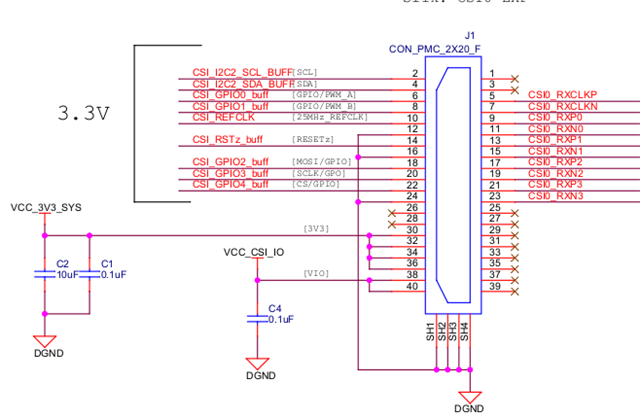

We are using the SK-AM62-LP kit to interface a CSI-2 camera (ST-56G3MAI1). Could you please confirm which supply should be used to drive the camera — VCC_3V3_SYS or VCC_CSI_IO?
We also need to control this supply at runtime ( for suspend, enable, disable, etc. ).

    Thanks for your patience. Could you please provide additional information on the request? What does "to drive the camera" mean?
    VCC_3V3_SYS is used for VDD/VCC
    VCC_CSI_IO is used for the IO

    We need to provide 3.3V power to the camera, and this power should be controlled (on/off) to allow suspend or stop modes for power saving.
    On the CSI-2 connector, two voltage rails are available: VCC_3V3_SYS and VCC_CSI_IO.
    From my understanding, VCC_3V3_SYS is also used to drive other peripherals or the SoC, so controlling it may not be feasible. Therefore, only VCC_CSI_IO seems specific to the camera.
    Could you please confirm if VCC_CSI_IO is the preferred option to power the camera?
    Gopal Sharma
    VCC_CSI_IO is used for the IO. This rail outputs 1.8V at startup and not 3.3V
    VCC_3V3_SYS is the only 3.3V VDD supply that goes to the camera connector and is only turned-OFF during "Partial IO" low power mode. If your application requires turning OFF this rail for CSI during specific scenarios, then I would recommend adding a power switch between VCC_3V3_SYS and the camera.
    Note: customers are responsible for protecting IOs that are not fail safe. Make sure voltage is not applied to an IO without having a valid voltage on the corresponding IO supply pin.
