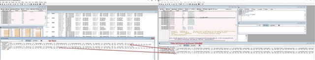

  • https://e2e.ti.com/cfs-file/__key/communityserver-discussions-components-files/791/mcspi_5F00_tx_5F00_dma.tar.xzHi Tarun:
    We has meet with customer about this issue. Some question need you help us provide some demo/suggest.
    1. At TDA4VH does we has MCU domain control MCU_SPIx master DMA loopback test case?
       we has modified TDA4Entry main MCU R5F control main McSPI0 Loopback demo at RTOS11.1 RDK, but TDA4VH we do not successful enable those examples. customer want based on our pure MCU domain DMA SPI loopback demo merge to their project.
    2. Based on last several week debug, customer think it relationship with MCU Domain SPI UDMA conflict, Do you has same suggest about analyze TDA4VH OS + MCU control SPI DMA debug method for customer?
    Below is our TDA4Ventry main MCU control SPI DMA_LOOPBACK example for you refences.
    Best Regards!
    Han Tao
    I don't understand why you are taking TDA4entry examples .
    we already have MCU SPI0 with DMA example in path mcusw/mcal_drv/mcal/examples/Spi/mcspi_app in TDA4VH
    You need to enable the DMA flag and give interrupt numbers 79 and 80 it will work fine.
    We can use the same example in MCUSW with DMA enabled in confi
    I have conveyed this before as well, why are you not considering MCAL example ?
    Tarun Mukesh
