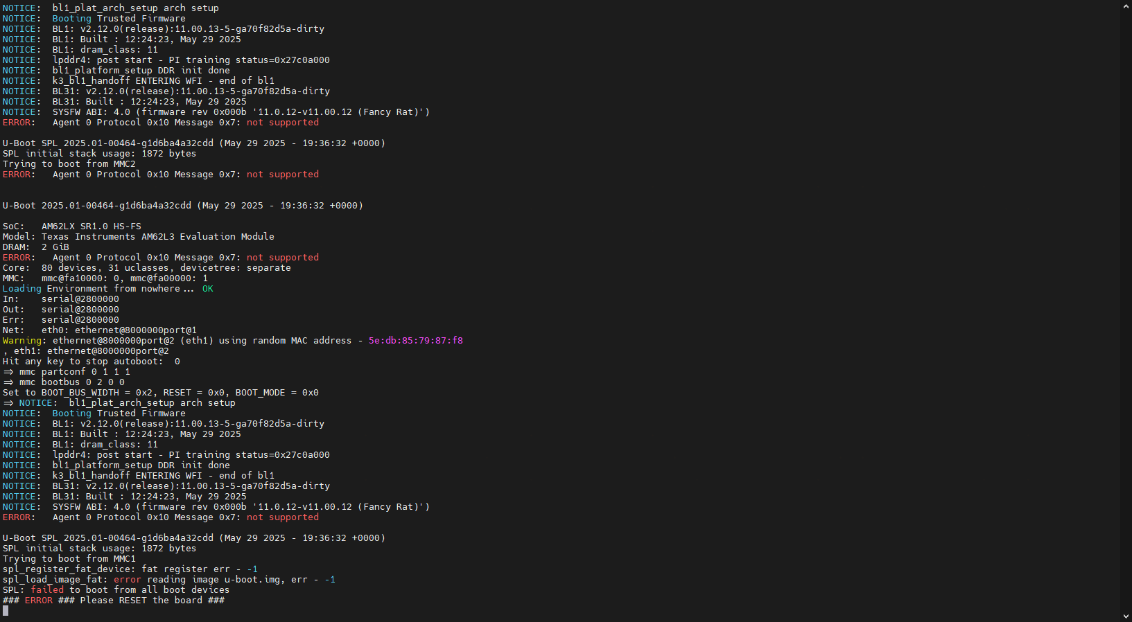

Dear Expert,
After customer set the switch mode and power cycle the EVM as below guidance for EMMC boot. The output of AM62L as below. The failure reason of this?
Which bootmode the customer is using here?

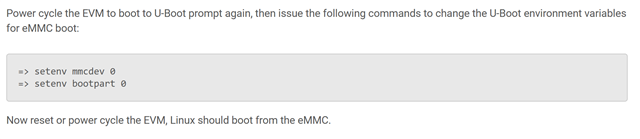

Hi Prashant,
Tony Tang and me tried this EMMC boot follow the below guidance.
4.1.3. How to flash eMMC and boot from eMMC UDA — Linux SDK for AM62L Documentation
We tried two version EVM board with same image and method:
1. PROC181E1(can boot up from EMMC)
2. PROC181E1-1(cannot boot up from EMMC)
So, we think this issue may related to the hardware difference. Could you double confirm this?

Hi Prashant,
Sorry, me and Tony didn't save the log. But the failure one has no log at all.
1. PROC181E1(can boot up from EMMC): we could see the bring up log.
2. PROC181E1-1(cannot boot up from EMMC): no log at all.
