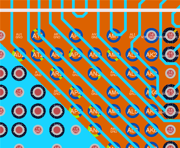

I'm in need to connect certain pads to VSS/GND to make a complete solid reference plane at the top because second layer is used as high speed signal.
I know that you should not connect certain pads/balls of the processor directly to VSS/GND because it can cause current rush. Therfore, it's recommended to add a pull-down resistor instead to protect the IO.

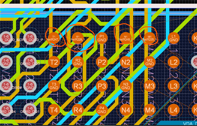

    Well, the reason is that I'm using 6 layer board and I have designed everything with only 6 layers. Including reference plane.
    But the last thing I need to do is to add pull-downs and pull-ups for DDR1 and DDR2. It seems like a easy task, but it's splitting the reference plane.
  • If IP is not being used, you can also remove the filters.  From previous example I used with VDDA_0P8_USB, you could remove L53, C321, C167, C168 (but still connect VDDA_08_USB to VDD_CORE_0V8.  Maybe that will help reduce the number of separate power rails in BGA area.
  • In this case. The most important thing is DDR1 and DDR2 and MMC0 because they creating holes in the reference plane.
    I don't like that because you should never break or split the reference plane.
  • A 6Lyr PCB is super aggressive for this device.  If I understand pics, there is no way to avoid issue if any via is connect to BGA pad?  Compromises might need to be made, possibly DDR data rate (void in reference).  CMOS input that are floating can potentially oscillate and damage the device - which is why recommendation to terminate some pins.
  • A 6 layer PCB does not has to be aggresive. Everything counts how well the design is.
    If I connect e.g DDR_DQS to VSS, then this issue disapears. But connecting them directly to VSS can harm because they are of the type IO.
    One thing I could do is to remove some balls from the array. But that's too time consuming.
