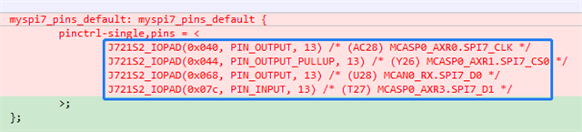

  • Here is the pins config of SPI7

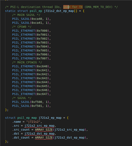

  • Hi Hawayi,
    My understanding is that PSIL threads were needed for enabling DMA for McSPI. J721S2/TDA4VE does not have PSIL threads for McSPI, so I do not think DMA is possible: https://software-dl.ti.com/tisci/esd/latest/5_soc_doc/j721s2/psil_cfg.html
    However, let me double check with the author of this app note just in case I am wrong: https://www.ti.com/lit/an/sprad26/sprad26.pdf?ts=1758666511555&ref_url=https%253A%252F%252Fwww.google.com%252F
    Takuma

  • Hi Tali,a:
    Here are my modifications, please help review if there are any errors. Thanks!
    Index: arch/arm64/boot/dts/ti/k3-j721s2-common-proc-board.dts
    --- arch/arm64/boot/dts/ti/k3-j721s2-common-proc-board.dts (revision 10713)
    +++ arch/arm64/boot/dts/ti/k3-j721s2-common-proc-board.dts (working copy)
    @@ -382,13 +383,19 @@
    &main_spi7 {
    + status="okay";
    pinctrl-names = "default";
    pinctrl-0 = <&myspi1_pins_default>;
    - status="okay";
    - spidev@0 {
    + spi-slave;
    + //ti,pindir-d0-out-d1-in;
    + dmas = <&main_udmap 0xc600>, <&main_udmap 0x4600>;
    + dma-names = "tx0", "rx0";
    + slave@0 {
    spi-max-frequency = <24000000>;
    reg = <0>;
    - compatible = "cisco,spi-petra";
    + compatible = "rohm,dh2228fv";
    Index: drivers/dma/ti/k3-psil-j721s2.c
    --- drivers/dma/ti/k3-psil-j721s2.c (revision 10713)
    +++ drivers/dma/ti/k3-psil-j721s2.c (working copy)
    @@ -248,6 +248,9 @@
    /* SA2UL */
    PSIL_SA2UL(0xf500, 1),
    PSIL_SA2UL(0xf501, 1),
    + /* PDMA8 (PDMA_MISC_G0) - SPI0-1 */
    + PSIL_PDMA_XY_PKT(0xc600),
    struct psil_ep_map j721s2_ep_map = {

  • Hi Hawayi,
    Checked with author of app note. Without PSIL, it is not possible to use DMA. So no support for DMA mode McSPI on J721S2.
    Takuma
  • Hi Takuma,
        Since the SPI slave mode depends on DMA, and the J721S2 cannot support DMA due to the absence of PSIL, SPI slave mode is also no longer supported?
    Hawayi
  • Hi Hawayi,
    That is my understanding... but it does sound strange to me that this would be the case. J721E architecture is similar to J721S2/TDA4VE architecture, and I see that k3-psil-j721e.c uses the "MISC" PSIL threads for SPI for both RX and TX DMA.
    J721S2 does not define these PSIL threads within k3-psil-j721s2.c for TX (although, RX PSIL are defined).
    And further looking into our TISCI documentations (https://software-dl.ti.com/tisci/esd/latest/5_soc_doc/j721s2/psil_cfg.html), it looks like the MISC TX threads that are in k3-psil-j721e.c should exist for J721S2 device as well
    So what you have done should be correct...

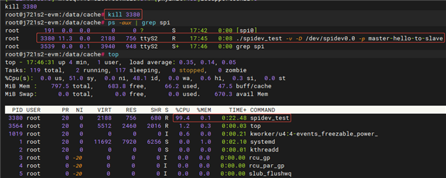

  • Otherwise, perhaps the large CPU load is caused by this blocking call to spi_sync and DMA is already set up?
    Below is description of spi_sync which is described as "blocking/synchronous SPI data transfers"
    In spidev.c, I see that the file operation for .write is spidev_write which then calls into ->spidev_sync_write->spidev_sync->spi_sync.
    Takuma

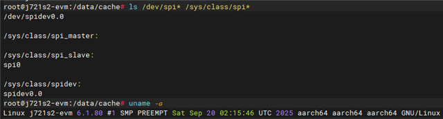

  • Hi Takuma,
    I tested the spidev_test application according to the documentation( https://www.ti.com/lit/an/sprad26/sprad26.pdf?ts=1758666511555&ref_url=https%253A%252F%252Fwww.google.com%252F) and found that it hangs when sending data exceeding 159 bytes regardless of whether -p or -i parameters are used. Attached are the operation logs for your reference - please help verify what's causing this issue. Thank you!
    Hawayi

  • Hi Hawayi,
    If some sort of loopback test is being done, looks like RX did not receive.
    Can you check where in the kernel driver it is hanging? I suspect it is hanging in spidev.c spidev_write function, since it does a spidev_sync_write which eventually calls into __spi_sync function in spi.c, whch has a blocking call to wait_for_completion.
    You can also confirm by taking a look at the source code:
    In the past on a different device that uses the same driver and same McSPI hardware as TDA4VE, I did not see hang issue when TX and RX were connected:  RE: PROCESSOR-SDK-J722S: mcspi slave mode hang?
    Takuma
