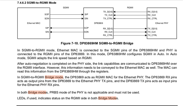

Hi
I’m using the following chain: CPSW MAC —(SGMII)—> DP83869 —(RGMII)—> ADIN1100.
I understand the DP83869 supports SGMII<->RGMII bridge operation.
My questions:
In SGMII→RGMII bridge mode, is the ADIN1100 (downstream RGMII PHY) the authoritative source of link status/capabilities, which the DP83869 then reports upstream to the CPSW/MAC?
Practically: will the DP83869 and the CPSW only show “link = yes” after the ADIN1100 reports link = yes, or are there configuration cases where DP83869/CPSW will show link up even while ADIN1100 is down?
Please confirm recommended register/strap settings to ensure correct propagation of link and autoneg
