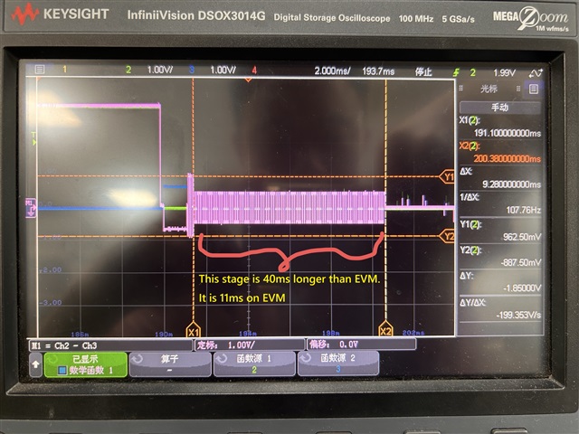

AM6442: AM6442: When performing DFU function via USB2.0, USB handshake failed.
Part Number: AM6442
Other Parts Discussed in Thread: UNIFLASH, LP-AM243
Problem description:
After the AM6442 chip on the self-designed PCB enters DFU boot mode, when using USB 2.0 to program SBL and APP, the host shows: "Unknown USB device (Device descriptor request failed)".
Relevant debugging results:
1.Compared the operation and results of USB DFU on the AM6442-EVM evaluation board. Under the condition of ensuring the operations are correct, the differential signals of the USB D and D- connections were measured separately using an oscilloscope. The summary is as follows:
1)On the self-designed PCB the signal data for RBL drives USB in DFU boot mode is shown in the table below:
Time(us
100000

3)There is a significant difference in the signals on the AM6442-EVM evaluation board when successfully running the USB DFU function. Whether during the RBL phase driving the USB device as an AM64x DFU device or after the SBL driving the USB as an AM64x-AM243x DFUS device, the signals captured by the oscilloscope are the same, as shown below:
Time(us
100000
150
1200
25
50
50
50
50
50
2.5
50
50
50
50
Voltagev
3
0
-0.5
0
-0.8
0.8
-0.8
0.8
-0.8
0.8
0.5
-0.5
0.5
-0.5
Note:In the red-highlighted part of the data, there are a total of 222 50us levels, alternating high and low levels, with the last level being low.

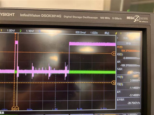

Overall diagram of the USB signal on the self-designed PCB board in SD card bootmode:
Detailed diagram of the USB signal on self-designed PCB board in SD card bootmode:
Overall diagram of the USB signal on the self-designed PCB board in DFU bootmode:
Detailed diagram of the USB signal on the self-designed PCB board in DFU bootmode:

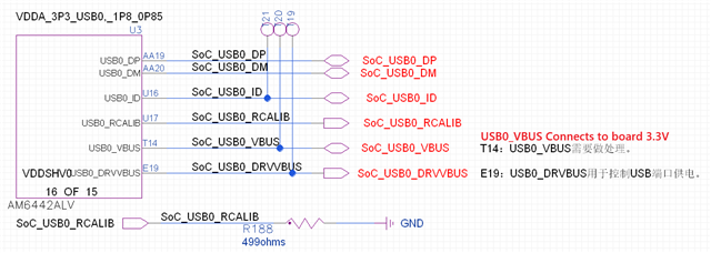

The hardware design diagrams related to USB are shown in the three images below:

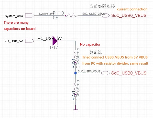

1)USB pin connection on SOC side, VBUS connects to board 3.3V, also tried with 5V with resistor divider, same result.

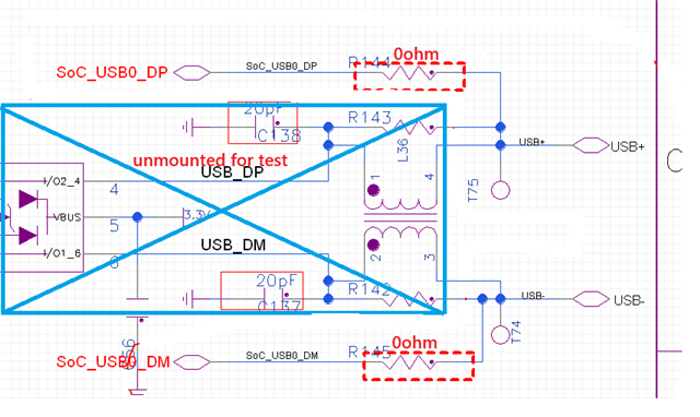

2)USB board connection, component in BLUE frame is unmounted for test. R144 and R145 are 0ohm

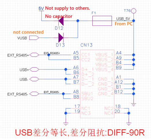

3)Type-C connector, USB differential equal length, differential impedance DIFF-90R
In addition to the foundation shown in the above three pictures, there are also the following attempts at changes and debugging:The ID is floated, and the vbus pin is changed to a voltage divider with 20k/10k resistors to 5V.

    Help me understand the EVM or SK that you referenced during the design.
    Can you share the customer board implementation for me to review before i reach out to the software expert.
    Have you had a chance to make some changes and test on the EVM?
    Sreenivasa

    I uploaded the relevant USB schematic at the end of the first post titled “Additional HW information 20250924". We also tried floating USB0_ID on the EVM to be same as my custom board, on EVM also work, but my custom board's issue keep same.
    We also attempted to modify the resistor on the USB0_VBUS pin (20k/10k) on my custom board. However, there were not many changes on result.
  • Hello Hebing Li,
    we also attempted to modify the resistor on the USB0_VBUS pin (20k/10k) on our self-designed board. However, there were not many changes.
    Can you describe the original connection.
    For USB device, USB voltage divider as per the data sheet is recommended.
    Can you please DNI the CMC and use the 0R to bypass.
    Is there a capacitor for the USB_5V after the diode 5V
    Can you please DNI the protection diodes on the USB signals to do a quick check.
    Sreenivasa
  • Hi Sreenivasa,
    I updated the circuit with comments.
    connect to board 3.3V, there are many capacitors on 3.3V on the board.
    Tried with 20K/10K divider to USB_VBUS 5V from PC, same result
    unmounted for test already. see updated schematic.
    No capacitor.
    they are unmounted during test already.
    The waveform during enumeration is longer on custom board than on EVM, is it the reason can't be recognized?
    Below is the waveform from EVM. pulse width are all 50us on either custom board and EVM board.

  • Attach the simplified connection in pdf. the upper one is designed connection, the bottom one connection just for comparison test, no improvement.
    (It is two board design, there are board to board connection, so draw a simplified connection.)
    Type-c to AM6x USB connection.pdf
    Can you please conform the USB supplies are connected as expected and have the capacitors.
    Detail in the .pdf
    Can you confirm if the USB connector used is a high-speed connector and the impedance control is considered.
    It is Type-c connector, the USB cable to connect to PC is verified with other type-c device.
    But there are board to board connection on the AM64x board also.  Anything detail needed, let us know.

  • Hello Tony,
    Here are some inputs i received from the expert
    Where is the Zener diode we require in the VBUS voltage divider circuit?
     The Zener is required to prevent exposure to an over-voltage condition.  For example, an over-voltage condition can occur by simply disconnecting a USB cable due to a sudden stop in current flow and the energy stored in the cable creates a kick-back voltage spike.
    The only time we allow a voltage divider without the Zener diode is when is constrained to 5V and the VBUS connectivity is contained on the same PCB assembly.
     The suggestion from the expert was to perform USB compliance test using standard USB test suite to access the signal quality - not sure if customer has had a chance to perform any of the USB
    Luis, please add any additional comments you may have.
    Sreenivasa
  • Where is the Zener diode we require in the VBUS voltage divider circuit?
    The board did not use the USB_VBUS from PC as power supply, just use 20K/10K resistor divider to get 3.xV for SOC USB_VBUS. and also tried to connect board's 3.3V to SOC USB_VBUS, but result is same.
    Do you still think Zener diode is necessary here?
    How to configure on SOC side to output test pattern?
  • Hello Tony,
    Thank you.
    In the supply used is a switched on-board 5V zener is optional, i assume the connector supply pin has no connection in that case.
