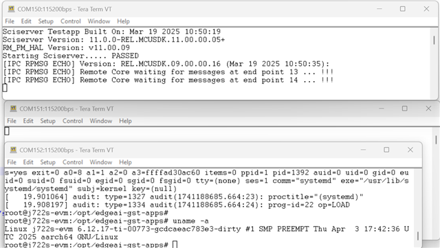

  • Hi Bin,
    I did comparison test summary:
    #1. default image boot log:
    #2. Change UBOOT dts only: No any log from either UART.
    #3. Change UBOOT dts and j722s.env together: no any log from either UART.
    #4. Change j722s.env file only: main_uart0 output log untill starting kernel, rest log output from wkup_uart as below:
    //WKUP_UART0:
    Sciserver Testapp Built On: Mar 19 2025 10:50:19
    Sciserver Version: 11.0.0-REL.MCUSDK.11.00.00.05+
    RM_PM_HAL Version: v11.00.09
    Starting Sciserver..... PASSED
    [IPC RPMSG ECHO] Version: REL.MCUSDK.09.00.00.16 (Mar 19 2025 10:50:35):

    //MAIN_UART0:
    lure. This will fail on Security Enforcing(HS-SE) devices
    Load Remote Processor 4 with data@addr=0x82000000 11804840 bytes: Success!
    22256128 bytes read in 229 ms (92.7 MiB/s)
    79529 bytes read in 4 ms (19 MiB/s)
    Working FDT set to 88000000
    6490 bytes read in 3 ms (2.1 MiB/s)
    ## Flattened Device Tree blob at 88000000
       Booting using the fdt blob at 0x88000000
       Loading Device Tree to 000000008fee9000, end 000000008fffffff ... OK
    Working FDT set to 8fee9000
    Starting kernel ...
