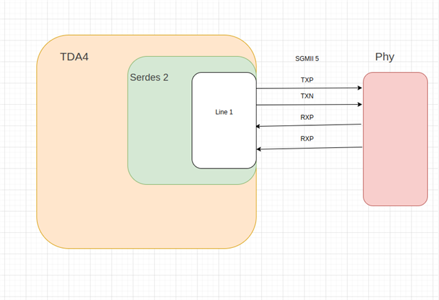

Hi Ti expert
SDK 0902 & 0806 & 0804
I used prebuild sd card.
How do I modify the code on the RTOS and Linux side
so that I can generate the corresponding ethn on the Linux side?
Best Regards
Eason

Are you looking for a virtual client on Linux and ETHFW on the MCU2_0 core as a server? If so, you need to update the RTOS side for configuring SerDes2 and MAC Port-5 in SGMII from the board_j721e_evm.c file and the application main file with the required ports.
If you are looking for a Native Linux solution, then you need to load non ETHFW application on MCU2_0 so the MCU2_0 core does not use CPSW9G. Update the Linux device tree for SGMII mode with SerDes2.
Additionally, refer to the FAQ for instructions on enabling CPSW9G on the TDA4VM.

Hi Sudheer
I want to this:
I want to use Virtual eth in linux;
And use PC and Linux network to communicate with each other
Best Regards
Eason
It means you are looking for a solution based on the ETHFW server and Linux client model.
Please refer to the changes required for porting to the custom board.
https://software-dl.ti.com/jacinto7/esd/processor-sdk-rtos-j784s4/latest/exports/docs/ethfw/docs/user_guide/ethfw_c_porting_top.html
Also, refer to the debug guide if you face any issues.
https://www.ti.com/lit/ab/sprads2/sprads2.pdf?ts=1759990680959&ref_url=https%253A%252F%252Fwww.google.com%252F
