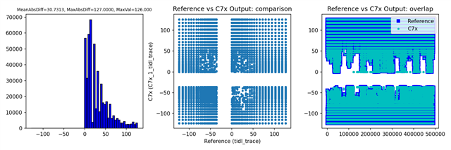

Enable layer level fixed point traces in both host emulation and EVM execution. This can be done by setting debug_level = 3
Next I generated traces with debug_level=3 set both in docker and on target device.
4.
Use any binary comparison tool (e.g. beyond compare, diff, cmp etc) to compare the traces_ref and traces_target folder
Next I used diff and cmp to compare these traces.
Further I plotted values from both traces against each other.
The layers that differ are:
tidl_trace_subgraph_1_0089_0001_0001_00001_00256_00001x00001.y
tidl_trace_subgraph_2_0162_0001_0001_00001_00008_00320x00192.y
tidl_trace_subgraph_2_0164_0001_0001_00001_00008_00320x00192.y
tidl_trace_subgraph_2_0166_0001_0001_00001_00008_00320x00192.y
tidl_trace_subgraph_2_0168_0001_0001_00001_00001_00320x00192.y
tidl_trace_subgraph_2_0170_0001_0001_00001_00001_00320x00192.y
tidl_trace_subgraph_2_0172_0001_0001_00001_00001_00320x00192_float.bin
  Layer SG2_0164
  Layer SG2_0166
  Layer SG2_0162
My question is what do I do next?
