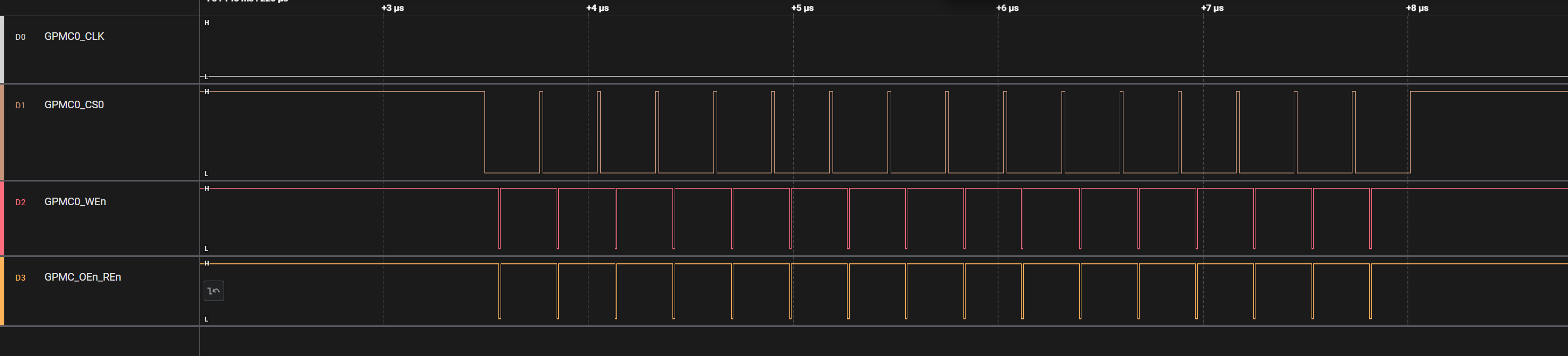

The code below is able to do transfers to the GPMC but from the captures it looks like it is doing 16 single transfers, and it is not driving the GPMC0_CLK pin, even though burst transfers are enabled in GPMC0_CONFIG1.
Questions:
- What else needs to be modified to enable burst mode?
- What are the maximum achievable burst sizes?
- 32 bit mode is not supported in sysconfig, can I just configure the device size to 32 GPMC_CONFIG1 and pinmux the rest of the pins to enable 32 bit mode, or is there more?
Capture:
This should be burst, but is doing 16 individual transfers

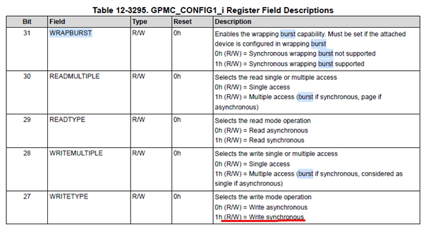

    CSL_FINST(*GPMC0_CONFIG1, GPMC_CONFIG1_WRITEMULTIPLE, WRMULTIPLE);
    CSL_FINST(*GPMC0_CONFIG1, GPMC_CONFIG1_READMULTIPLE, RDMULTIPLE);
    CSL_FINST(*GPMC0_CONFIG1, GPMC_CONFIG1_READTYPE, RDSYNC);
    CSL_FINST(*GPMC0_CONFIG1, GPMC_CONFIG1_WRITETYPE, WRSYNC);

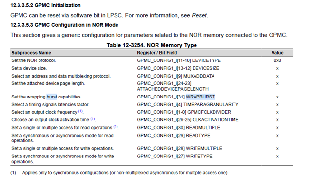

  • Hello Keaton Clark,
    I am really wondering if you might configure GPMC communication to be asynchronous.
    Can you please confirm if you configure asynchronous or synchronous communication ?
    In asynchronous communication, the clock is not presented.

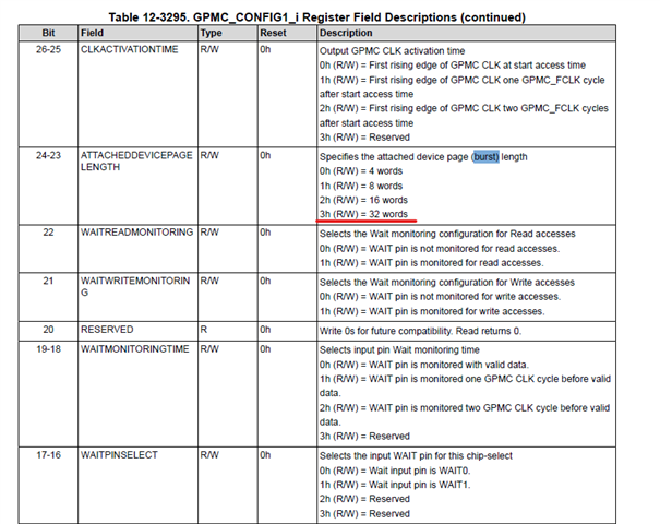

    Yes, the MCU+SDK driver does not support 32bit. If you want 32bit, then go with changing the 32bit mode and, accordingly, configure the pin mux settings.
    If you need different burst sizes, we can play with a burst size selection.
    The maximum burst size can be supported to 32words.
    So, you can configure the icnt0 to the maximum burst size.
    I need your full project to look at the your code, or I have created an FAQ to auto-trigger DMA based on the GPIO input.
    In this example, I have used the GPMC with the DMA. You can follow the same implementation for the GPMC with DMA .
    In your setup, how did you initiate the GPMC. Did you initiate with syscfg ?
    Please try with these settings and confirm the your Test results .
    https://e2e.ti.com/support/processors-group/processors/f/processors-forum/1378150/faq-how-to-trigger-dma-with-the-help-of-gpio-on-am64x-am243-and-am62x-devices
    Anil.

    I am just curious about what the burst size is configured and how the icnt0 is configured.
    I assume that if the burst size is 16 words, then we need to configure the icnt0 = 32 (bytes) and inct1=length/32
    Here is your setup. If you configure it to 16bit, then 1 word is = 2 bytes.
    Please confirm what your setup is ?
