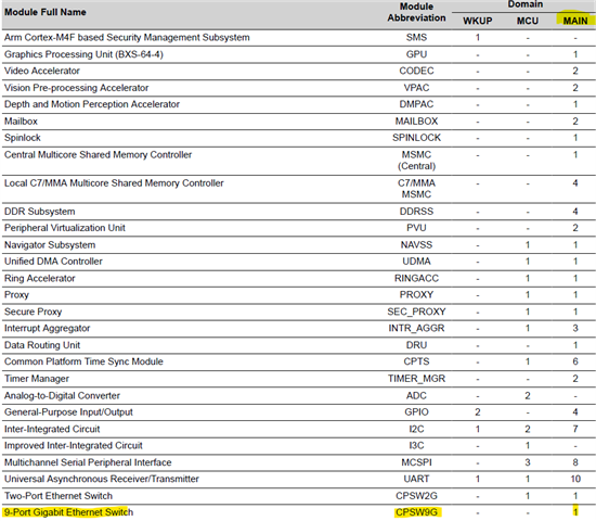

I am working with the TI TDA4 J784S4 SoC and referring to the attached SPRUJ52D Technical Reference Manual (TRM). I need clarification on the interaction between the A72 core, the R5F firmware, and the CPSW9G switch, specifically regarding access to the CPTS (Common Platform Time Sync) module for timestamping.
From the TRM, I understand that:
  • CPSW9G is part of the MAIN domain as mentioned in this table at section 1.1.3.
  • Section 12.2.2.1.1 confirms that CPTS is a part of the CPSW9 switch.
  • CPTS is designed to supports both software and hardware timestamping and provides mechanisms for precise time tracking and synchronization across various subsystems. I’m particularly focused on the CPTS functionality within the CPSW9 switch, as my development scope involves creating a kernel driver for VxWorks that runs on the A72 core and performs diagnostic testing related to the CPTS registers in CPSW9.

    CPTS from CPSW9G is configurable only when CPSW9G is enabled.
    I am not sure about the drivers used in VxWorks. If you can access CPSW9G registers, then you will be able to access CPTS.
    If you are using the ETHFW model applicaiton from the R5F core, then only R5F has access to CPTS registers. In this case, you can't implement the diagnosis from the A72 applicaiton running on VxWorks.
