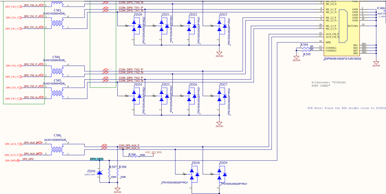

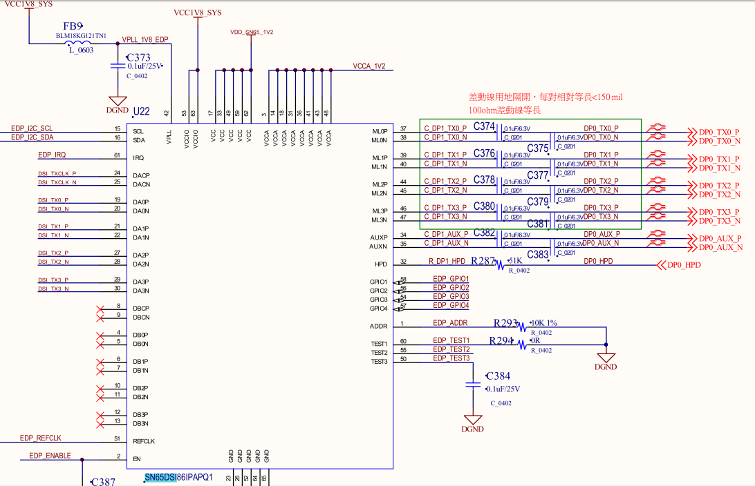

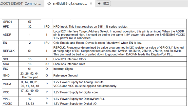

  • Hello Jeff,
    On the DP0_HPD signal, i see a 51K series resistor.
    Nou sure on the use case, in case the hot plug does not work with the patch please measure the HPD signal and make required changes.
    Sreenivasa

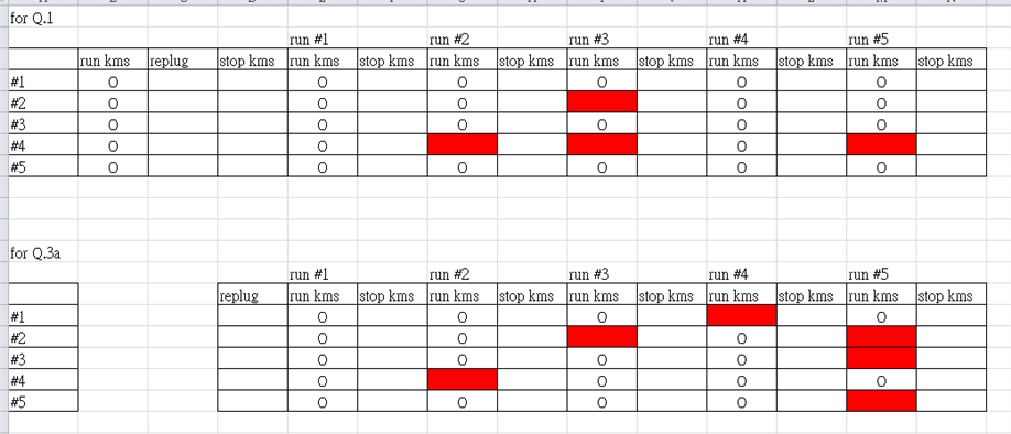

  • Hi Expert,
    I try again, and find it can show display again in this process:
    1. boot on -> show TI login in screen
    2. run kmsxxtest -> show color blocks in screen
    3. unplug & plug DP cable -> show nothing
    4. stop kmsxxtest -> show nothing
    5. run kmsxxtest -> show nothing
    6. stop kmsxxtest -> show nothing
    7. run kmsxxtest -> show color blocks in screen
    8. stop kmsxxtest -> show TI login in screen
    But I run my application like this process, but I can't get same result. Any suggestion?
    BR,
    Jeff
  • Hi Jeff,
    Can you please check for the above.
    Please share your complete dts for display related part as well.
    In the sn65dsi86 driver, what is ti_sn_bridge_detect() function returning? Can you add a print for (val & HPD_DEBOUNCED_STATE)?
  • The ti_sn_bridge_detect() function should print that value on hotplug or post kmsxxtest run.
    Also, before each kmsxxtest run, can you share the logs of `modetest -D 30220000.dss`
  • Hi Expert,
    I will ask HW people check 51K series resistor next week.

    And got this log when I test for kmsxxtest by the process:
    1. run modetest
    3. unplug & plug -> didn't get ti_sn_bridge_detect msg, show nothing in screen
    5. run modetest
    6. run kmsxxtest -> show color blocks
    root@am62pxx-evm:~# modetest -D 30220000.dss
    trying to open device 'i915'...done

  • Hi Jeff,
    I see a few differences w.r.t. https://git.ti.com/cgit/ti-linux-kernel/ti-linux-kernel/tree/arch/arm64/boot/dts/ti/k3-j722s-evm.dts?h=ti-linux-6.12.y#n836 in your dts like gpios and lane-polarity/data-lanes. Can you share the reason for these.
    Also, I see that post unplug/re-plug of DP cable, your hotplug seems not to work while there is an already running application or if you run something for the next time. but it does work on the second time.
    To understand your issue in more detail, can you share:
    1. Once kmsxxtest starts working post hotplug, does it keep working for all subsequent kmsxxtest runs (not just 1, say 5 to 10) reliably, or it works only randomly?
    2. Does it seem to be a delayed hotplug detection? As in, if you have kmsxxtest running, and perform hotplug, does kmsxxtest start working in approximately the same time in which you ran your second kmsxxtest in above experiment?
    3. Or, does it seem to only work (reliably) after second kmsxxtest run?
        3a. What if you do not have kmsxxtest running in background, perform hotplug, run kmsxxtest twice and it starts working after second run?
    4. Do you have any other driver related changes in your kernel related to the DP/DSI bridge or DSS driver?

    1. For 51K series resistor, we follow the document:
    2. For HPD signal. It is 0v when unplug, and it is around 1.8v when plug.
    3. It is customized board, so we set gpio for our condition:

    test process: run kmsxxtest -> replug -> stop kmsxxtest -> run kmsxxtest 5 times. and test 5 times totally.
    "O" means: it shows color blocks in display, otherwise, it shows black screen.
    "Red" means: it should show something, but it didn't
    So it seems kmsxxtest is not reliable.

    8. For Q3a in previous ticket. See picture in No.5.

  • Hi Expert,
    I removed those lines and retried.
    For Board -> DP -> DP to HDMI converter -> Capture -> PC, it still fails to resume the display while running kmsxxtest after replug.
    For Board -> DP -> DP Monitor, I will test it next week because the DP Monitor was borrowed.
    BR,
    Jeff
  • Hi Expert,
    I removed those line and test:
    For Board -> DP -> DP Monitor, kmsxxtest sometimes fail to show display without hotplug. Also, it fails to resume the display while running kmsxxtest after hotplug.
    BR,
    Jeff
