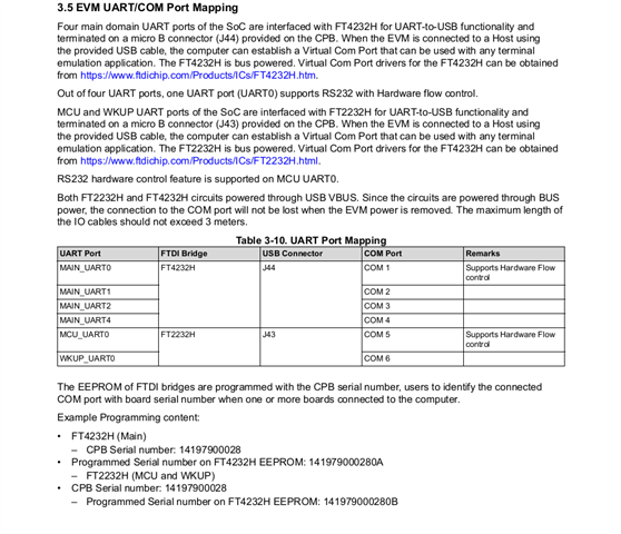

    Please take a look at the following FAQ: How to test serial UART ports on board for changing the UART instance used.
    Additionally, note for the J721E EVM, here is the EVM UART Port mapping:
