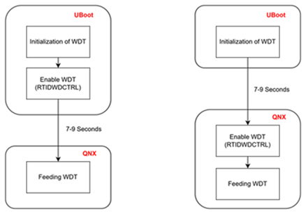

  • Hi Keerthy,
    They are trying these two approaches, a mix of uboot and QNX
  • I am now trying in linux (u boot only) ,this also not resetting with the above rti_wdt.c,when I read using md ,status register showing 0x32
    • If this goes well I will try mix of u-boot and qnx
  • Hi Charan,
    This works in linux, we have showcased it to your team. But we made modifications in the uboot to ONLY ENABLE WATCHDOG, hence you will not be able to completely reset the watchdog.
    madhruya
