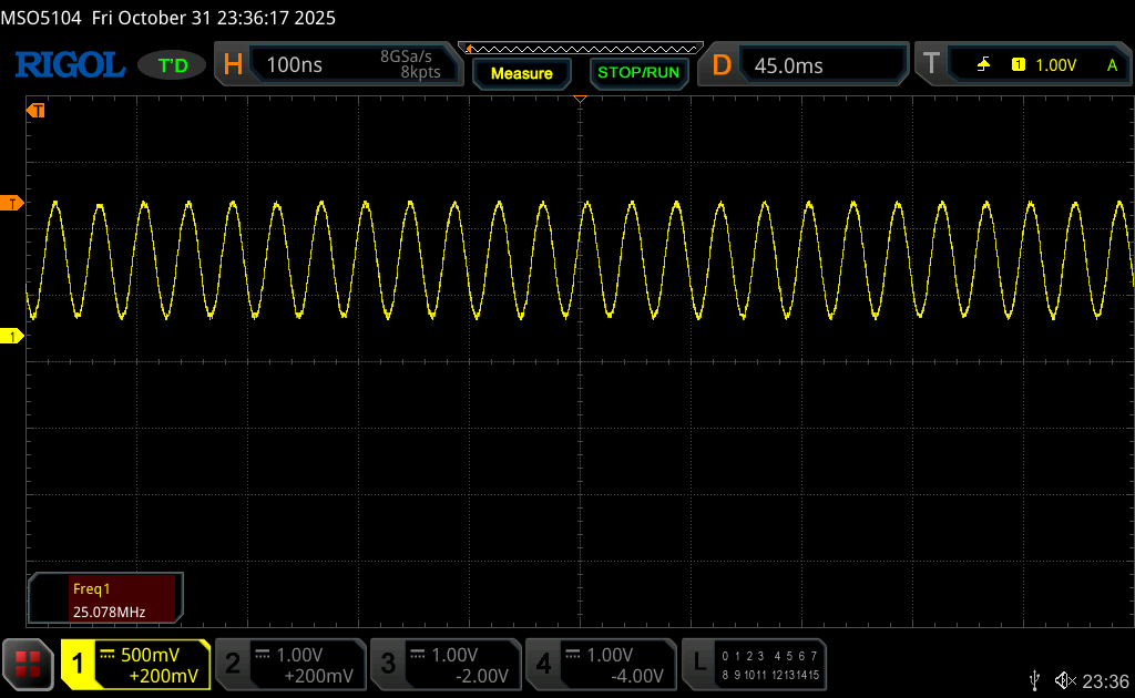

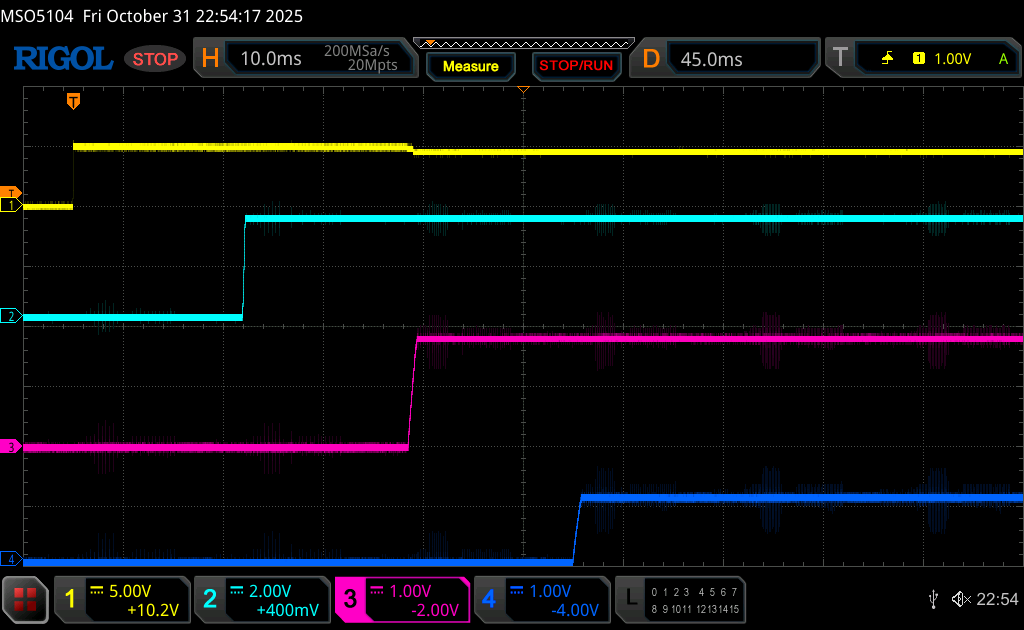

Upon power up of our new board the converters are outputting the designed voltage, the clock is running at 25 MHz, MCU_PORz is high, RESETSTATz is high, and PORzOUT is high.
 Ch1: VSYS, Ch2: VDDA3V3, Ch3: SoCDVDD1V8, Ch4: VDD_LPDDR4 RigolDS5.png
 Ch1: VDD_LPDDR4, Ch2: VDD_CORE, Ch3: MCU_PORZ
Ch1: Clock
