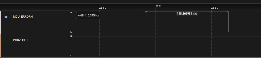

When RTI watchdog timeout, the MCU_ERRORN toggled from high to low.

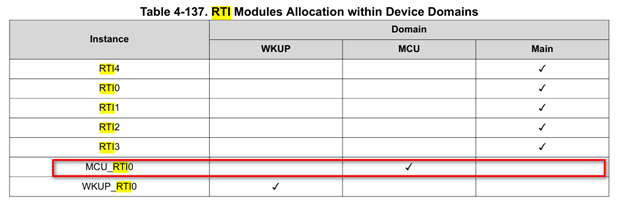

  • uint32_t RTI_devices[RTI_NUM_DEVICES] =
    TISCI_DEV_MCU_RTI0,
    No, I just used the MCU_RTI0 in the MCU domain.

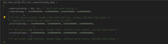

  • Hello WZ,
    Please try the change below.
    If this still does not work, I can join for a debug call tomorrow after 11AM IST.
    The RTI MCU Interrupt is routed to ESM at the 85th bit position.
    So, we need to set the 85th bit.
    After updating this bit, compile the code, load an example and see if it works or not.

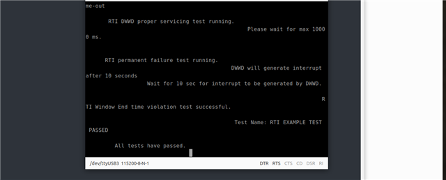

  • Hello WZ,
    I have verified the SD boot flow at my side, and I observed that the RTI interrupt is not getting triggered, and instead, the SoC is going into a reset.
    I noticed the same behavior during our call today on your setup as well.
    To generate the interrupt correctly (instead of a reset), the following two steps need to be followed:
    1. Disable the MCS ESM instance in the DTS file (as already shared by Nihar).
    2. Disable the reset trigger bit in the CTRL MMR register  after the watchdog timer expires.
    After applying the above two changes, I was able to see that the WDT interrupt is successfully triggered on the M4F core and the SoC no longer resets immediately.
    Can you please apply the same changes on your side and share your test results/logs for confirmation?

  • Follow your suggested steps, and we can get into the ESM callback now.
    But we still have the question. Why? In the SPL bootflow, we need to disable the reset trigger bit in the CTRL MMR register.
    Is the reset trigger bit in the CTRL MMR register disabled in the default SBL bootflow?
  • Hello WZ,
    Yes, the above understanding is correct.
    By default, the 17th bit is 1, which means the Reset should not trigger after the MCU WDT expires.
    In the SBL boot flow, the register is never touched and has the default values.
    But coming to the Linux boot flow, this register was set to zero and enabled the MCU_ESM.
    Due to this, M4F core not getting an interrupt and triggers the SOC reset.
    Anil.
