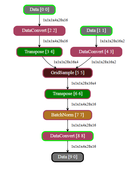

J784S4XEVM: Request for Patch or Guidance on GridSample Model Issue (SDK 11)
Part Number: J784S4XEVM
Other Parts Discussed in Thread: AM69A
As recommended in the thread 784S4XEVM: Graph Verify Failed when running a model with Gridsample, I tested the SDK 11 code and included everything related to GridSample. I was able to reproduce the same artifacts during model compilation:

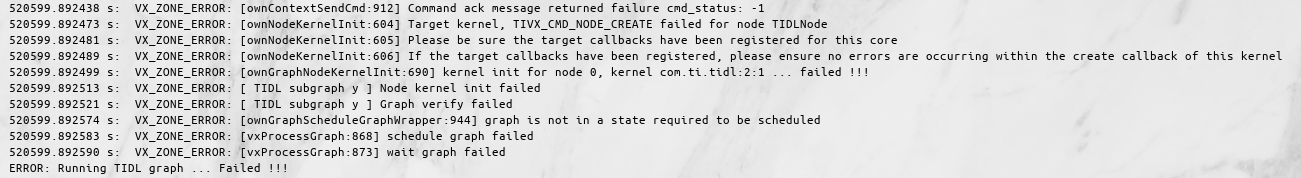

However, the board is still getting stuck, as shown below:
I am using the same model referenced in the earlier discussion: 8738.gridsample_model.zip
Is there a patch or guide available to fix this issue?
Any additional instructions you can share would be appreciated.

  • Hi Ghassen,
    Have you followed the following steps here to enable the backport? https://github.com/TexasInstruments/edgeai-tidl-tools/blob/11_00_07_00/docs/update_target.md
    Warm regards,
    Christina
  • Hello Christina,
    In the steps provided in the link, they only describe how to update the target for SDK 10.1
    As you can see here:
    I also checked update_target.sh, and it seems that 10_1 is the only SDK version supported there.
    Can you confirm if other SDK versions are expected to be supported or if there is an alternative method?
  • Hi Ghassen,
    Based off of your E2e that you linked, I was under the understanding you are using SDK 10.1. The edgeai-tidl-tools version 11_00_07_00  is backwards compatible with SDK 10.1, meaning without changing the SDK, you can use the update_target.sh script to make it compatible with the 10.1 version, but with the updates/fixes that occurred after the 10.1 release.
    If you are using a different SDK, please let me know exactly which Processor SDK version you are using, as well as exactly which edgeai-tidl-tools version you are using as well.
    I suspect you have the wrong pairing of versions together, and this is the reason why you are running into the hang on board, especially if it runs on PC emulation.
    Warm regards,
    Christina
  • Hello Christina,
    Yes, I’m using SDK 10.
    As you suggested, I tried testing the backport solution for edgeai-tidl. Below are the exact steps I performed on the EVM:
    cd edgeai-tidl-tools
    git checkout 11_00_07_00
    export SOC=am69a
    export SDK_VERSION=10_1
    export TISDK_IMAGE=adas
    ./update_target.sh
    Unfortunately, it still didn’t work on the board — I’m seeing the same error: “Node kernel init failed.”
    Is there anything I might have missed in the steps?
    Or do you have any other suggestions I could try?
    Thank you,
    Ghassen
  • Hi Ghassen,
    After running the update script, did you reboot the device before running TIDL? This step is necessary to see the needed changes.
    Also did the update script complete without any errors?
    Warm regards,
    Christina
  • Hello Christina,
    Yes I did the reboot and there were no error during the execution of the script.
    You can see the logs here:
