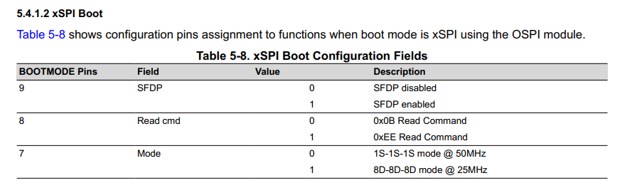

I. Referring to Table 5-8 in TRM, I think there are three modes for xSPI: 1S, 8D and SFDP.
Based on the Figure 5-5 in TRM, I think the boot process will not be affected whatever bootmode pin 7 and 8 are configured when bootmode pin 9 is set 1. I would like to confirm whether my comprehension above is correct.

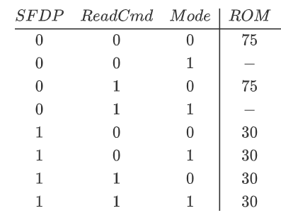

II. I have done a small experiment with arranging bootmode pins [7], [8], [9] and the result is shown as a table below. From the table, I found the ROM boot time could be reduced when SFDP is enabled, which is a valuable information I have confirmed one week ago from E2E. But I also found the boot process failed under 8D mode, which is contrary to the statements in TRM saying " For 8D-8D-8D mode of operation, the ROM will issue a Fast Read command (0x0B or 0xEE, depending on BOOTMODE signal), followed by a 32 bit (4 byte) address (the starting address is all zeros)". For this circumstance, I have flashed a SBL1 image and I set a GPIO low at the beginning of main() function, similar to TI's SBL time measurements tutorial (4.1.12. Boot Time Optimizations — Processor SDK AM62Px Documentation ). But the test pin I have measured is always high so I think the software is stuck in ROM boot.

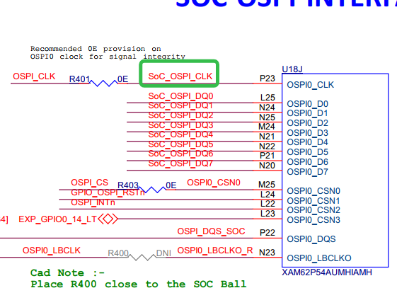

III. Referring to Figure 5-5 in TRM, it says the operating frequency is 25MHz when SFDP is enabled. However, the OSPI_CLK I have measured during ROM boot is 5MHz. The test pin is shown below.
I could also attach the oscilloscope screenshots below. I wonder whether this phenomenon is normal during ROM boot. If the answer is negative, what should I do to help OSPI_CLK to reach 25MHz during ROM boot.

  • Hello Fan,
    When using xSPI but without SFDP enabled, the ROM expects the 4 byte address to be sent as per the bootmode description. You can read this under the xSPI bootloader description from the TRM.
    Now the flash, when it undergoes a PORz and ROM starts booting, is in a reset state which means it is in 3 bytes addressing state.
    This also means that the NVCR is actually configured by default to 3 byte addressing, and hence this value gets copied to VCR itself.
    So in order to boot purely in 8D-8D-8D, I see that you would need to set NVCR to 4 byte addressing such that upon PORz, the reset value is 4 byte addressing itself, and hence the booting will take place.

  • I think the boot process will not be affected whatever bootmode pin 7 and 8 are configured when bootmode pin 9 is set 1
    Yes your understanding is correct, it will be a NO CARE, when SFDP is enabled, but it is always a good practise to have them at 0, reason being we have not validated for numerous boot cycles if having 7, 8 as any random value when SFDP is enabled does not cause any issue. So in theory yes 7, 8 will be a NO CARE, but good to set it to 0.

  • Hi Bomiao,
    You should be measuring the R415, and not R410 to see the proper clock.
    Vaibhav
  • Hi Vaibhav,
    For measuring the signal of OSPI_CLK, I think R415 and R401 are equivalent. Now I could get 50MHz when measuring the OSPI_CLK during ROM and SBL 1 after adjusting the parameter of oscilloscope. Sorry about my mistakes.
