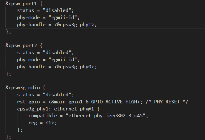

We are currently using am62a7 for our project, and the SDK version we are using is: ti-processor-sdk-linux-edgeai-am62a-evm-10_01_00_05. The PHY chip we are using is TJA1103. Our test environment is as follows:
Below is the configuration in the device tree. It is the same for both uboo and in the Linux environment, as follows:

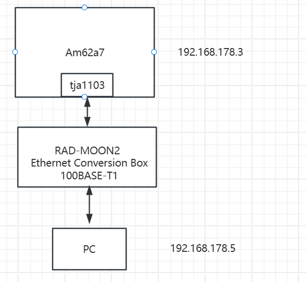

A ping test was conducted between the PC and the am62a. The following issues were discovered:
1. When the Ethernet was initialized under U-boot, after entering the Linux system, the network was normal and pings could be made between the PC and the am62a7.
2. When the Ethernet is not initialized in U-boot, after entering the Linux system, the network becomes abnormal and there is no ping connectivity between the PC and the AM62A7.

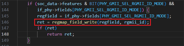

    3. Finally, we discovered that, based on the current SDK, the bit 4 of this register was not configured on the Linux platform. After modifying the following code, the Ethernet function on Linux worked properly.
    linux/driver/phy/ti/phy-gmii-sel.c:
    The specific configuration process is as follows:

    Just to clarify, this issue is only observed when you are using RGMII_ID mode? If, for example, you had used "rgmii_rxid" mode as specified in the AM62A TI EVM DTS: https://git.ti.com/cgit/ti-linux-kernel/ti-linux-kernel/tree/arch/arm64/boot/dts/ti/k3-am62a7-sk.dts?h=ti-linux-6.12.y-cicd#n792, do you also see the same problem when U-boot initialization is disabled?
    May I ask if there was particular reason for using rgmii_id mode (as you have also indicated in your DTS snippet) as opposed to rgmii_rxid mode?
    Good to know that you have found a way to address your issue with this modification. When you use this solution, if U-boot Ethernet initialization was kept enabled, does Ethernet also still function correctly in Linux?
