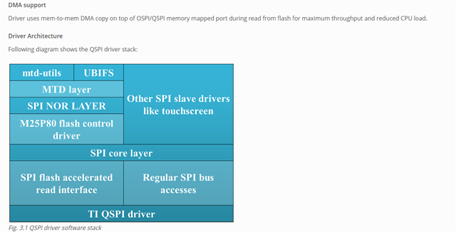

    Our team still want to try the OSPI because the current hardware is with OSPI.
    So, the plan now is to emulate the FPGA as flash to use mem-to-mem DMA copy on top of OSPI/QSPI memory mapped port during read from flash for maximum throughput and reduced CPU load as stated in the SDK documentation.
    https://software-dl.ti.com/processor-sdk-linux/esd/AM62X/latest/exports/docs/linux/Foundational_Components/Kernel/Kernel_Drivers/QSPI.html
