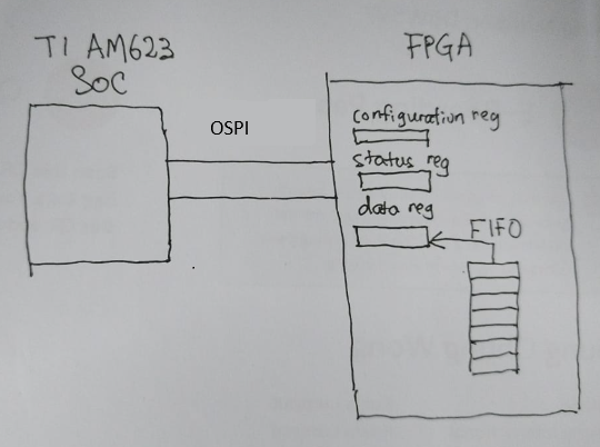

We are exploring to use PRUSS on AM623 to transfer data from FPGA into the system memory at the rate of 1M samples per second, with each sample is 64-bit.
So, the effective data rate will be 64M bits per second. The data in the system memory will then be consumed by Linux application running at A53 core.
Not sure if the PRUSS is able to support this data rate using serial port? Or it needs to be a parallel port for this rate?
If yes, how to get started? How is the hardware connection?
Any example will be helpful ...

    Good question. Let's talk about usecase a bit:
    1) Would this transfer happen with a standard communication protocol, or a custom serial / parallel protocol?
    2) What transfer rates does your FPGA support? Does it allow for parallel ports?
    3) Would the PRU need to do any processing of the data before making it available to Linux?
    4) What kind of throughput would the system need? Is this a constant throughput of 64Mbits/sec, or would this be sporadic data (that was sent at 1Msamples/sec when there was data to send)
    5) What is Linux doing with this data? (totally understand that usecase may be sensitive, feel free to talk about this in vague terms or send to me in a direct message)

    1) Actually currently we are trying to use OSPI in the indirect mode to transfer the data in A53 Linux, but 64Mbits/sec maybe out of the OSPI limit.
    2) Yes, it allows parallel ports as we are trying OSPI now.
    3) Most likely not, just need PRUSS to arrange the data in a ring buffer in memory, and update the next write index. A53 Linux application will poll and look at this write index to determine if there is new data in the ring buffer to be processed. Basically, want PRUSS to function like a DMA to A53.
    4) 64Mbits/sec is the maximum throughput, and is a constant rate from the front end. The rate can be less than that with different configuration.
    5) A53 Linux application will get the data from the ring buffer and apply the measurement algorithm to each sample, and push to the reading memory one by one.

  • 1) Actually currently we are trying to use OSPI in the indirect mode to transfer the data in A53 Linux, but 64Mbits/sec maybe out of the OSPI limit.
    Surprised by this though - OSPI with 8 data lines can hit 64 Mbps with 8 MHz clock, afaik you can do 25 MHz without enabling OSPI PHY.
    open-pru/examples/pru_emif at main · TexasInstruments/open-pru is parallel interface (emif client) emulation example using PRU.
    open-pru/examples/spi_loopback at main · TexasInstruments/open-pru is serial interface emulation using PRU. only way to achieve 64 Mbps here using multiple data lines based on the numbers listed
    GPMC throughput also depends on FPGA side implementation too - but 100 MB/s kind of performance can be achieved based on GPMC CLK :  AM5728: GPMC throughput with FPGA

    Below is the brief description of our use case.
    The FPGA will generate 1M samples per second (8 bytes per sample) continuously until user stops it, and we need to transfer those samples continuously from FPGA into the memory that A53 Linux can access.
    The front end will fill the FIFO at the rate of 1M samples per second (8 bytes per sample) continuously, and A53 Linux will need to pull the samples into the memory by reading the data register continuously for further processing.
    Instead of using A53 Linux, we are thinking to use the real-time core like M4F or PRUSS to pull the samples over the OSPI interface.

    Transferring 64Mbit/sec is absolutely doable in hardware. However, we do not have an out-of-the-box solution for you. All of these options will require software development.
    1) DMA + GPMC: 8 bit parallel interface + trigger signal to tell DMA to read in the 8 bit parallel interface at 8MHz. Requires Linux driver development
    2) PRU bitbanging a SW OSPI (i.e., PRU emulating OSPI): 8 bit parallel interface + OSPI control signals. Requires PRU assembly development. Defining a shared memory region to pass the data back to Linux userspace should not be an issue, as I just had another customer verify the zerocopy shared memory example between Linux + PRU
    3) PRU controlling the HW OSPI peripheral: This is probably doable, but I have not looked at the design to see if read / write latency between PRU and OSPI peripheral would be a concern. Could use MCU+ driver as a reference to write PRU firmware. May be able to write the PRU code in C instead of assembly, and use the same zerocopy concept to send the data to Linux for consumption
    I misspoke about the M4F controlling OSPI, apologies. The MCU+ docs clarify that the DM R5F supports OSPI, but not the M4F core:
    https://software-dl.ti.com/mcu-plus-sdk/esd/AM62X/11_01_00_16/exports/docs/api_guide_am62x/DRIVERS_OSPI_PAGE.html
    So option 4) could be that you write custom DM R5F code to interact with the OSPI, as discussed in the AM62x multicore academy here:

  • Hi  Nick,
    Our processor board currently only routes the OSPI lines to external connector that can be used to interface with FPGA. If OSPI is able to work, then we do not need to go to GPMC interface which requires hardware board change.
    Ok, M4F+OSPI is out of the option. PRU+OSPI option seems to have even more unknown.
    Understand that the primary role of the Device Management (DM) R5F core is to run the DM task.
    So to add a new task to read 1 sample (8 bytes) per microsecond from OSPI interface, will it cause problem to the DM task?
    Because the read will be continuous until user stops it. The last thing we want to see is the DM task and the sample reading task stepping on each other.
    If that will not cause problem to the DM task, then I am happy to start a new e2e thread to discuss for R5F+OSPI option.
    rgds,
    kc Wong
  • Hello KC,
    If you set your task priorities correctly, then the DM task should be the only one with the highest priority. So the DM task will not be impacted by the OSPI read, but if the DM task may interrupt the OSPI read if the rest of the system makes a request. The amount of time the DM R5F spends on the DM task is hugely usecase-dependent (e.g., is there dynamic power scaling that requires frequent power management requests that go through the DM?). I do not know if there is a good way to benchmark how long the DM R5F spends in the DM task before returning to other tasks, but I am also not an MCU+ programming specialist. That may be a good discussion for a new thread.
    Nick
