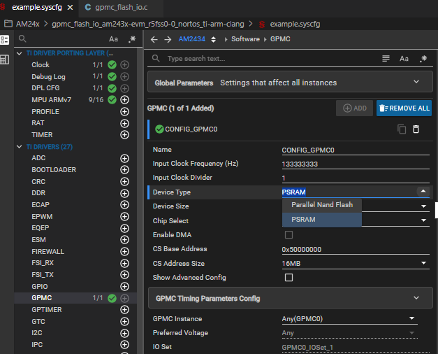

Q2:When connecting a NOR Flash to the GPMC, is it correct to configure it as “PSRAM” in SysConfig?
The MX29LV160D is an asynchronous device.

  • Hello OH,
    In the MCU+SDK, we don't officially support NOR flash memory on GPMC. However, with some modifications, the existing PSRAM driver infrastructure can be adapted to work with NOR flash.
    You can try the following steps:
    1. Generate the code for PSRAM using SysConfig
    2. Copy the generated code into a new file to create a separate NOR driver, then remove the PSRAM configuration from SysConfig
    3. Set the device type to NOR memory (GPMC_DEVICETYPE_NORLIKE), Mode either it is synchronous or Asynch and Timing parameters .
    4. Implement the erase function, which is not present in the PSRAM driver. NOR flash requires sector/chip erase before programming, using command sequences specific to your device (MX29LV160D)
    5. For read operations, you can use the same functionality as PSRAM since NOR memory is memory-mapped and read works directly
    6. For write/program operations, you cannot use direct memory writes like PSRAM. NOR flash requires CFI command sequences to program data. This involves sending an unlock sequence  followed by the program command  then writing the actual data to the target address, and finally polling for completion. The existing GPMC_norWriteData() function can be used to send these individual command writes, but you need to implement the proper command sequence wrapper for programming.
    To read and write via GPMC, there are no dedicated tools available. You will need to use the GPMC examples as reference for implementing your read and write operations.
    Also, there are currently no plans to support GPMC-based Secondary Boot Loader (SBL).
    Anil.
    I understood. I'll try extracting just the GPMC settings from "ti_drivers_config.c" generated by .syscfg and customizing them for NOR.
    Just to be sure, is "GPMC_MEM_TYPE_NORLIKE" an explicit definition for users?
    In "gpmc.h", PSRAM and NORLIKE are treated the same.
    I understand that changing it to "GPMC_MEM_TYPE_NORLIKE" will not change the APIs and variables referenced by the software.

  • Hello OH,
    The device type macro is the same for both NOR and PSRAM memories (GPMC_MEM_TYPE_NORLIKE = GPMC_MEM_TYPE_PSRAM = 1).
    Therefore, if the device type is already initialized as PSRAM, there is no need to set it again for NOR memory. This step can be skipped.
    Anil.
