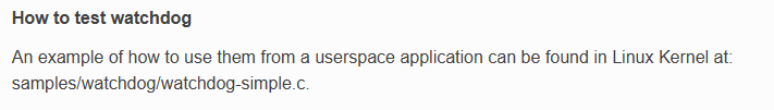

I enabled WDT with reference to the following.
https://software-dl.ti.com/processor-sdk-linux-rt/esd/AM62LX/11_02_08_02/exports/docs/linux/Foundational_Components/Kernel/Kernel_Drivers/Watchdog.html
I ran the WDT sample C code using the following as a reference.
However, it will reset after about 60 seconds.
