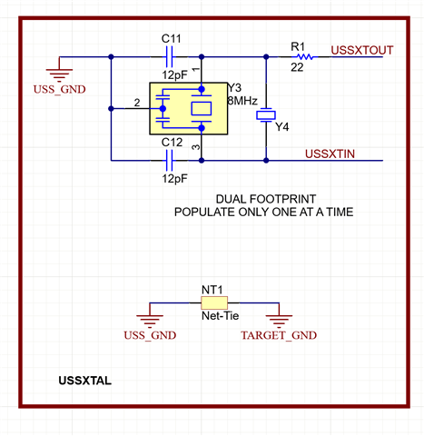

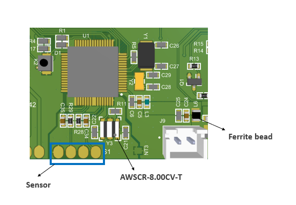

  • Thank you peter for the reply, in fact we have used "AWSCR-8.00CV-T", which is a ceramic resonator as it is in the reference design "TIDM-02005". Please let me know which part of the schematic you need, then I can add it here, for now a I added the crystal part. Let me know of you need more info.
    Behnam,
  • Hi Behnam,

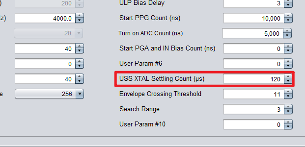

    The crystal part looks fine to me because it is the same as the TI reference design, one initial suspicion is that it may be caused by the not enough settling time for the crystal, but since you use the resonator and follow the TI design I think it should be fine, but you can also increase a little bit of the XTAL Settling count as shown below to see whether it do help with the issue.

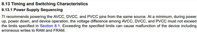

    In addition, according to what you mentioned, this issue only occur when repower the whole system with cold start, but then reset or reprogram the system can be resolved, so another suspicion is the unstable initial power supply or any other over-spec risk in the hardware that will cause FRAM corruption which described in the datasheet, so I would suggest you to test below items to see if there is any pulse spikes or over-spec when power up.
    • Check all pins (including AVCC/DVCC/GPIO/ADC Input…) to see if exceeding the DS specified limits.
    • Check the voltage difference between AVCC and DVCC to see if exceeding the DS specified limits.
    • Check the power on sequence, make sure there is no external input voltage on the pin before DVCC/AVCC is stably powered on.
    And I noticed that you use battery to power the system, you can try to perform a test with connecting the system to a more clean digital power supply outside to see if the issue still occurred.

    But in general, I still recommend to test the hardware items in the previous reply, and also you can use oscilloscope to capture the VCC waveform when first power on to see if any pulse spikes that exceed much more than the VCC absolute spec in the datasheet.

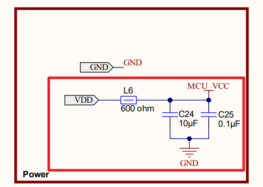

    Moreover, could you please share with me the schematic part of power supply part and MCU related part, I want to check if there is any potential concern.
    Peter

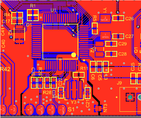

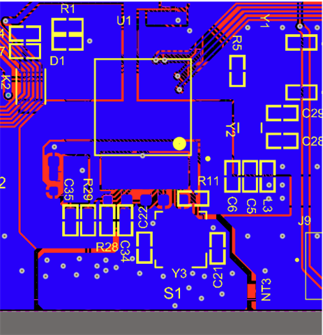

  • Dear Peter,
    Please find the schematic and layout attached.
    Please let me know if you have any questions.
     MSP430FR5043IPM.pdf
  • Hi Behnam,
    For the Power part, please try to replace the L6 with a 0Ω resister and increase the C24 to the 47uF to see if it can do help with the issue, and please note to use VDD as the stable 3.3V for the test.
    Peter
