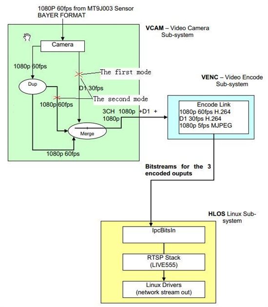

    1.I read the datasheet of sensor(MT9J003_DS_B), and find it have 1080P mode(60 fps using HiSPi I/F), I think the DM8127 is using this mode, Is it correctly? And how to change the sensor output mode?
        The data flow is:
         Sensor data--->FPGA---->ISP, if we can set the sensor to output other mode(full frame), did the FPGA have limitation of the resulation?
    2. in the file multich_tristream_lowPower.c,
    /*------------------------------ TRIPLE OUT <1080p + D1 + MJPEG> ----------------------------------
                                    Capture (YUV420)
             RSZA     RSZB
                                    1080P60   D1_30
                           ___________|   |
           DUP(0)------|   |
           (1)    -----------
         SIMCOP   MERGE
         (MJPEG)     |
          BITSOUT(VPS)  IPCM3OUT(VPS)
           BTSIN(A8)     IPCM3IN(VID)
               H264ENC
              BITSOUT (VID)
              BITSIN (A8)
     In the source of IPNC, I cannot see any codes about the RSZ setting. Can you tell me?

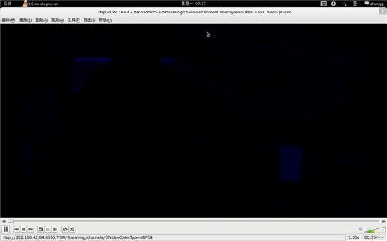

  • I can get single MJPEG. I modify the codes as follows:
    the follow codes are in  the multich_tristream_lowPower.c file.
            /* IPC Bits Links */
    //System_linkCreate(gVencModuleContext.ipcBitsOutRTOSId, &ipcBitsOutVideoPrm, sizeof(ipcBitsOutVideoPrm));
    //System_linkCreate(gVencModuleContext.ipcBitsInHLOSId, &ipcBitsInHostPrm0, sizeof(ipcBitsInHostPrm0));
    but the Background  of the MJPEG  stream is very black and a little blue..
    when the camera output h264(1080p or D1 or both ) and mjpeg ,the h264 stream and mjpeg stream  are all ok.
    That is why? Can you give us some advices? Thanks a lot!
    attach the pic.
  • Hello Gomo,
    Is your usecase is to encode MJPEG only and stream MJPEG only? Then your usecase is not achived by the modifications done.
    The lowpower usecase by default encodes all three (1080p H264, D1 H264 and 1080p MJPEG) and stream only what ever is requested.
    If your usecase is to stream only MJPEG, run the default with out modification and try seeing the MJPEG stream as you are seeing now.
    Actually by this change the A8 side of the system is not receiving any information from M3 side to stream.
    hence no streaming is happening..
    Can you exactly tell what the usecase is?
    Is it MJPEG Encode only and MJPEG Streaming only?
    Venu

        I modified the multich_tristream_lowPower.c to single H.264, but not modified the function of Init_StreamEnv();
       Because the default value of pConfig -> nStreamType is 2, so the following function will exit.
       if(WaitStreamReady(pConfig -> nStreamType) != 0) {
           ApproDrvExit();
            __E("WaitStreamReady Fail.\n");
           return -1;
     SetDisplayValue(pConfig -> nDisplay);
     SetImage2AVendor(pConfig -> nAEWswitch);
     SetImage2AType(pConfig -> nAEWtype);
     Set2APriority(pConfig -> expPriority);
     SetTvSystem(pConfig -> imagesource);
      I modified the above sources and The camera can output single H.264;
      And the following steps:
      1)Output single MJPEG;
      2)Change to more big resolution.
      When meetting problem, I will post issue again. Thanks a lot!
  • hi venu,
        When modify to multich_tristream_lowPower.c to single Mjpeg, I meet problem again.Now I describe the process.
        1) Cut off the D1 H.264, we can get two 1080P H.264, can not get 1080P H.264 + 1080P Mjpeg, just see the "The first mode" of pic;
        2) Cut off the D1 and one 1080P 60fps, we can single 1080P H.264, can not signal 1080P Mjpeg, just see the "The second mode" of pic;
        3) I test another combination, such as D1 MJPEG and two 1080P H.264, they all work well.
        So I get a result: if I want to output Mjpeg stream, It's must set to tristream. Is it correctly? Or give me some advice?
        Another questions
        1) where do it control the MJPEG frames to 5? I modify the function of MjpegLink_codecCreate(), It do not become effective.
     pChObj->frameSkipModulo = 1; //12;               /* Default value
                                                                                      * of
                                                                                      * frameSkipCounter
        2) In lowPower mode of IPNC2.0, The Mjpeg encode is also in VENC, but in IPNC1.8, it's finished by SIMCOP(FullFeature mode also use it IPNC 2.0)? what's the difference?
        Thanks a lot!
  • Hi Gomo,
    I think when ever you arecuting out D1, you are facing issue. That is issue occurs whenever following is true in usecase file. But nothing to do with MJPEGE.
    pCameraInstPrm->numOutput = 1;
    This is a bug which we also identified which would be fixed in the next release.
    Venu
  • Let me answer the second question first:
    In IPNC1.8,  MJPEG encoding is always done by SIMCOP.
    In IPNC2.0, MJPEG encoding is done by SIMCOP in FULL FEATURE mode where as MJPEG encoding is done by HDVICP2/IVAHD in Low Power mode where SIMCOP is totally not clocked.
    Coming to the First Question of controlling, MJPEG Encoding frame rate, as your usecase in a variant of Low Power Mode you should look into the encLink which does the encoding on IVAHD. Esp encLink_jpeg*.*
    In MJPEG Encoding link on SIMCOP, this is controlled by pChObj->frameSkipModulo = inputFrameRate/targetFrameRate;
    In MJPEG Encoding on HDVICP2/IVAHD, this is controlled by EncLink_doSkipFrame() which depends on the further two variables of inputFrameRate and targetFrameRate.
    Venu
  • Thanks for your quick reply!
    I modified the fullfeature usecase to get 1080P MJPEG and D1 H.264, and also modified pChObj->frameSkipModulo = 20,  It's not become effective, the skip fps + fps = Total fps. I don't unstand. I modifyed pChObj->frameSkipModulo = 1, the result is same.
    Attache the source and log file.  Thanks a lot.

  • Hi Gomo,
    Following logic in the file mjpegLink_common.c controls the number of frames encoded or skipped.
    if ((pChObj->curFrameNum % pChObj->frameSkipModulo))
    skipFrame = TRUE;
    Can you put a printf to see what is the frameSkipModulo was is taking?

  • hi venu,
        I had  set  the pChObj->curFrameNum to different value (such as 10, 6 ), The running result show the MJPEG have not change(5 or 6 fps), I thinks the limitation of MJPEG is on the  SIMCOP; Tomorrow,  I will use the lowpower usecase to modify the MJPEG fps.
       Can you make sure the limitation of the SIMCOP?
    Thanks a lot!
  • Hi venu,
        Yestoday, I modified the function of MjpegLink_codecCreate(), in fullfeature usecase.
        pChObj->frameSkipModulo = 5; //12;
       and modify your advice place to same value
                    skipFrame = TRUE;
     It do not become effective. the result have no change.   But I find the In Recv FPS also decrease.
     [m3vpss ]  ==================== MjpegLink_PrintDetails ====================
     [m3vpss ]
     [m3vpss ]  *** MJPEG ENCODE Statistics ***
     [m3vpss ]  Elasped Time           : 41 secs
     [m3vpss ]  --------------------------------------------
     [m3vpss ]  CH  | In Recv In Skip In User  Out Latency
     [m3vpss ]  Num | FPS     FPS     Skip FPS FPS Min / Max
     [m3vpss ]    0 |      32       0              26             6  11 /  13
     [m3vpss ]  =================================================================
      So today moring, I modified like this,
                In MjpegLink_codecCreate(),
        pChObj->frameSkipModulo = 12;
                    skipFrame = TRUE;
     The result is incredible: tristream, we get 1080P MJPEG @62. Using VLC to see the MJPEG stream, It's very fluent.
     [host] MCFW_IPCBITS: Callback function:App_ipcBitsInCbFxn
     [host] MCFW_IPCBITS:App_ipcBitsRecvStreamFxn:INFO: periodic print.. [m3vpss ]  ==================== Mjp
     [m3vpss ]
     [m3vpss ]  Elasped Time           : 13 secs
     [m3vpss ]    0 |      62       0            0               62  11 /  21
     [m3video]  *** ENCODE Statistics ***
     [m3video]
     [m3video]  Elasped Time           : 28 secs
     [m3video]
     [m3video]
     [m3video]  CH  | In Recv In Skip In User  Out Latency
     [m3video]  Num | FPS     FPS     Skip FPS FPS Min / Max
     [m3video]  --------------------------------------------
     [m3video]    0 |      60       0        0  60 255 / 663339
     [m3video]    1 |      30       0        0  30 255 / 663323
     [m3video]
     [m3video]  =================================================================
     I don't understand why, Can you tell me? And about the frameSkipModulo value, where had it been modified again?
     BTW, next step, we plan to modify the resolution, I know  set the sensor register, but about the capture size and the RSZ setting, I need your advice.
     Maybe your a advice will get twice the result with half the effort.

  • Hi Gomo,
    The picture looks as if the AWB/AE algorithm is not running or not able to do the compensation. Can you confirm if you h.264 outputs of the YUV output is fine?
    If streaming is running at your end - I suggest to open the web gui and try changing the 2A vendor.
    Rajat Sagar
  • Rajat Sagar said:
    Hi Gomo,
    Rajat Sagar
    Thanks a lot. About the picture blue light, we had found what cause this phenomenon.

  • hi all,
      Today I try to modify the resulotion(frist stream 1080P to D1, encode to MJPEG),
    but the pic is not correct.
     /* First stream */
     pCameraOutPrm = &pCameraInstPrm->outParams[0];
     pCameraOutPrm->dataFormat = SYSTEM_DF_YUV422I_VYUY;
     pCameraOutPrm->scEnable = FALSE;
     pCameraOutPrm->scOutWidth = 720; //1920
     pCameraOutPrm->scOutHeight = 480; //1080
     pCameraOutPrm->outQueId = 0;
        The left is D1 H.264, the right is D1 Mjpeg; It's can see the MJPEG stream scene is
    small than the H.264, it seem to cut out the scene of right corner.
    Anybody can give me some advices?
