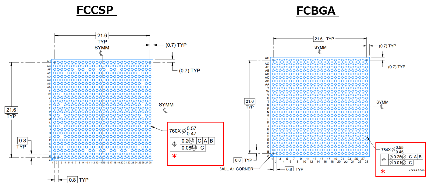

Hi Support Team,
The documentation regarding this redesign states the following.
www.ti.com/.../slaz774a.pdf
Explanation
The TDA2P, DRA7xxP, and AM574x devices in the FCCSP package technology were redesigned using an
FCBGA package. This FCBGA package offers datasheet-equivalent electrical and thermal performance – all
specifications from the datasheet noted below apply. It is also footprint-equivalent to the original package.
When referencing the device data sheet, use the new package designator in place of the discontinued package
designator throughout the document.
Is my understanding correct that the 24 added pins; from 760 to 784, are NC pins?

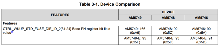

Also, while the model number changes, since only the part indicating the package changes,
is my understanding correct that the following CTRL_WKUP_STD_FUSE_DIE_ID_2[31:24] remains unchanged?

    The new package will have the same 760 ball footprint, so the picture on the right is not correct.
    The BASE PN field will stay the same as long as the same part number is used.  However, not all ABZ part numbers will be made available in the AQF variant.  You can refer to the PCN document for info on which new part numbers are recommended.

    Q1. The picture above is included in the following document. Are you saying that this document is incorrect?

  • Q1.  The existing document only gives the package diagram for the APB package, which is the new package for the previous ACD part numbers.  We are currently updating the document to include the AQF package diagram.

    Additional follow-up regarding Q1:
    When will the updated documentation with the AQF package figure be released?

    Q1: Updates to the "Package-discontinued and redesigned" notice will be available in ~2 weeks.
    Q2: I will email you the package diagram for AQF so that you have the info now, and not have to wait for our documentation cycle.

    I received your email with the attached file containing the package diagram for AQF.
    I will share it with my customer.

    That register value should not change if the new part is the AM5746AQFX.

    Since your reply stated “should not change” rather than “will not change,”
    does this mean that, basically, no changes are expected?
    If there are any apparent differences in the values, when will this become clear?
