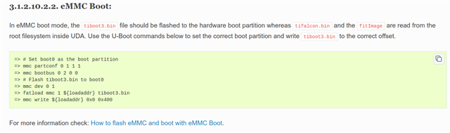

Hi Expert,
My environment: AM62P + SDK v11.1
I follow TI's doc to produce Falcon mode, and get same errors with this ticket: https://e2e.ti.com/support/processors-group/processors/f/processors-forum/1608247/am62p-booting-linux-from-emmc/6235361?tisearch=e2e-sitesearch&keymatch=AM62P%25252520AND%25252520Falcon%25252520AND%25252520eMMC#
My error message:
U-Boot SPL 2025.01 (May 28 2026 - 10:20:48 +0800)
SYSFW ABI: 4.0 (firmware rev 0x000b '11.1.2--v11.01.02 (Fancy Rat)')
SPL initial stack usage: 17088 bytes
Trying to boot from MMC1
spl: no partition table found
SPL: failed to boot from all boot devices
### ERROR ### Please RESET the board ###
This customized board can be booted with non-falcon mode + eMMC, so I think partition table of eMMC should be correct.
The author modified am62px.env to fix the problem, but I didn't see patch code inside the ticket. Can you help?
BR,
Jeff

  • Hi Jeff,
    The partition for booting the "tifalcon.bin" is defined by the "CONFIG_SYS_MMCSD_FS_BOOT_PARTITION" config in the "k3_r5_falcon.config" file.
    Can you please try the following patch to boot the "tifalcon.bin" from the 1st partition instead of 2nd partition, which wouldn't have the partition table?
    diff --git a/configs/k3_r5_falcon.config b/configs/k3_r5_falcon.config
    index b6762b35f74..ce739053e84 100644
    --- a/configs/k3_r5_falcon.config
    +++ b/configs/k3_r5_falcon.config
    @@ -13,7 +13,7 @@ CONFIG_OF_SYSTEM_SETUP=y
     # We use the rootfs (i.e partition 2) for booting which is ext4 not FAT
     CONFIG_SYS_MMCSD_FS_BOOT=y
    -CONFIG_SYS_MMCSD_FS_BOOT_PARTITION=2
    +CONFIG_SYS_MMCSD_FS_BOOT_PARTITION=1
     CONFIG_SPL_FS_EXT4=y
     # Loading tifalcon instead of tispl which has FDT and A53 SPL saves time
    Vinu
  • Hi Vinu,
    I apply that patch, and copy falcon files to partition#1, but it still show same errors. Then I find "CONFIG_SPL_FS_FAT=n" existed in my k3_r5_falcon.config. After set "CONFIG_SPL_FS_FAT=y" and do again, I get error:
    U-Boot SPL 2025.01 (May 29 2026 - 16:27:08 +0800)
    Partition 1 invalid on device 0
    spl_register_fat_device: fat register err - -1
    spl_load_image_fat: error reading image boot/tifalcon.bin, err - -1

  • Hi Jeff,
    Can you share all the steps you did in detail? Share patches that you've applied too.
    I've verified the steps listed in the other thread on SDK 11.02, I've shared the bootlogs too.
    So it would help if the steps are verified. Also, please let me know how you've created the falcon image. (SDK or Yocto)
    Vinu

    Please share the latest config file too.
    Vinu
  • Hi Vinu,
    I checked again, and found I missed U-boot patch in https://software-dl.ti.com/processor-sdk-linux/esd/AM62PX/11_01_05_03/exports/docs/linux/Foundational_Components/U-Boot/UG-Falcon-Mode.html 3.1.2.10.
    After apply this patch, format eMMC to a single partition, and modify "mmcdev=0", "bootpart=0:1" in am62px.env, now it can run to kernel loading. Here is the log:

    And I find the define of K3_HW_CONFIG_BASE & PRELOADED_BL33_BASE isn't consistent in these four chapters: 3.1.2.10.1.1 , 3.1.2.10.1.3 , 3.1.2.10.2.3, 3.1.2.10.3. May it cause my problem in tidss?
    BR,
    Jeff
  • Hi Jeff,
    Glad to know that you could find out the missing link.
    This means that the tifalcon and fitimage is working.
    The correct values are PRELOADED_BL33_BASE=0x82000000 and K3_HW_CONFIG_BASE=0x88000000.
    Thanks for pointing this out, we will correct it in the SDK doc.
    The tidss issue is a driver level issue, it is not a memory-level problem.
    Please make sure you are using the correct kernel and dtb to create the fitimage.
    I've tried this out in both SDK 11.2 and 12 and was able to successfully boot with the given instructions with the pre-built kernel and dtb.

    Can you share your steps to populate the eMMC rootfs?
    Vinu
  • Hi Vinu,
    Thanks for your help. I will try to solve tidss issue then.
    For one rootfs partition in eMMC, I just use fdisk to erase all partitions in /dev/mmcblk0 and create one ext4 partition.
    Thanks again.
    BR,
    Jeff
  • Hi Jeff,
    Please try this out.
    Right now, your falcon boot is completely fine. The issue seem to be solely on the kernel/dtb side. Try to use the same kernel that you have used in the SD boot, to create the fit-image.
    Vinu
