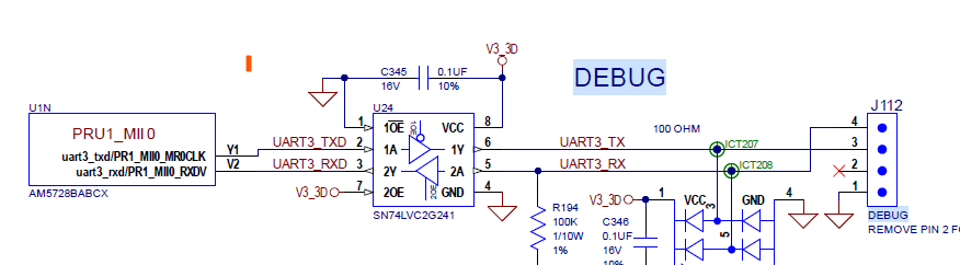

My custom board is based on AM5728 .
Earlier i was using u-boot version 2016 and its works fine .
but now i wanted to use u-boot 2019 version, i did the same configuration as did in 2016 version but i wont able to see the debug u-boot logs on port.
I changed ChangesFile.txt in these files.

  • Hi Hanmant,
    Can you please check if you are using proper UART port in custom board according to 2019 u-boot version?
    Anil
  • Hi Anil,
    Thank you for responding.
    What do you mean by Uart Port?
    Where to check that
    I already using 2016 version that works fine on my custom board.

    I see in the schematics of AM572x_IDK :
    UART3_Txd : Y1
    UART3_Rxd: V2
    Which is correct. But as I don't have the exact schematics you shared, Not able to see SN74LVC device.
    Can you please share me the schematics that you are using.
    Anil
  • Hi  ,
    same early_padconf  im using but there is no debug logs.
    UART3_Txd : Y1
    UART3_Rxd: V2  correct im using these balls.
    apart from this do i need to change anywhere ?

  • and also we need to remove the following lines from core_padconf_array_essential_am572x_idk[] structure in Mux.h file
    {UART3_RXD, (M11 | PIN_INPUT_PULLDOWN)}, /* uart3_rxd.pr1_mii0_rxdv */
     {UART3_TXD, (M11 | PIN_INPUT_PULLDOWN)}, /* uart3_txd.rp1_mii_mr0_clk */
    Anil
  • checked after removing these lines as still there is no output.

  • can you please change interrupts-extended parameters as below:
    &uart3 {
    status = "okay";
    interrupts-extended = <&crossbar_mpu GIC_SPI 69 IRQ_TYPE_LEVEL_HIGH
    &dra7_pmx_core 0x248>;
    Anil
  • sorry, It is already configured as 0x248.

            {UART2_TXD, (M0 | PIN_OUTPUT)}, /* uart2_txd.uart2_txd */
            {UART2_CTSN, (M2 | PIN_INPUT)}, /* uart2_ctsn.uart3_rxd */
            {UART2_RTSN, (M1 | PIN_OUTPUT)},        /* uart2_rtsn.uart3_txd */
    +       {UART3_RXD, (M0 | PIN_INPUT)},  /* uart2_ctsn.uart3_rxd */
    +       {UART3_TXD, (M0 | PIN_OUTPUT)}, /* uart2_rtsn.uart3_txd */

            {UART2_CTSN, (M2 | PIN_INPUT_SLEW)},    /* uart2_ctsn.uart3_rxd */
            {UART2_RTSN, (M1 | PIN_INPUT_SLEW)},    /* uart2_rtsn.uart3_txd */
    +       {UART3_RXD, (M0 | PIN_INPUT_SLEW | SLEWCONTROL)},       /* uart2_ctsn.uart3_rxd */
    +       {UART3_TXD, (M0 | PIN_INPUT_SLEW | SLEWCONTROL)},       /* uart2_rtsn.uart3_txd */

  •  {UART3_RXD, (M0 | PIN_INPUT)},  /* uart2_ctsn.uart3_rxd */
    but here i see that uart2_ctsn and uart2_rtsn are being selected instead of UART3_RXD and UART3_TXD?
    muxMode as 0?
    If you have the schematics can you please share here?
    Anil
  • Hi
    Check out the Debug uart schematic
  •   do you have any idea about this?

  • Hello Hanmant,
    It is hard to tell what exactly could be the reason you are seeing this abort. Given the thread history, and the diff you shared I have some ideas that can perhaps help guide you.
    1. What piece of code is telling the CPU to branch to such a low address? that is one place to start.
      prefetch abort
      pc : [<00000118>]          lr : [<841002f0>]
    2. Please look into this app note: https://www.ti.com/lit/an/sprac44a/sprac44a.pdf
      To ensure the IO timing values published in the Timing Requirements and Switching Characteristics tables of the AM57xx data manual over the lifetime of the device, the AM57xx software must implement the proper pad configuration requirements. The impact of not following these requirements may not be observed immediately. However, in the long term, failure to adhere to this procedure may cause system issues.
      1. Changing padconfig via DT should be avoided when possible.
    3. The issue you are seeing could still be a DDR issue
      1. Did you follow the DDR app note: https://www.ti.com/lit/an/sprac36e/sprac36e.pdf?
      2. Why did you have to change these?
      3. Can you enable more logging in order to figure out your issue?
        EX:
        # CONFIG_SYS_CONSOLE_INFO_QUIET is not set
        CONFIG_DEBUG_UART=y
        CONFIG_DEBUG_UART_OMAP=y
        CONFIG_LOGLEVEL=7
        CONFIG_LOG=y
    -Josue
  • Hi
    Can you please check this thread, AM5728: What was the resolution to the previous poster's issue?
