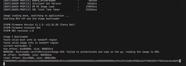

there is an issue that SOC AM62A4 can not bootup  after input a  hareware reset  LOW to pin "MCU_PORZ" .    this issue is a  proprobabilistic event,  it doesn`t not aways happene.
1From the log , it seems SOC is in uart bootmode ; log attached

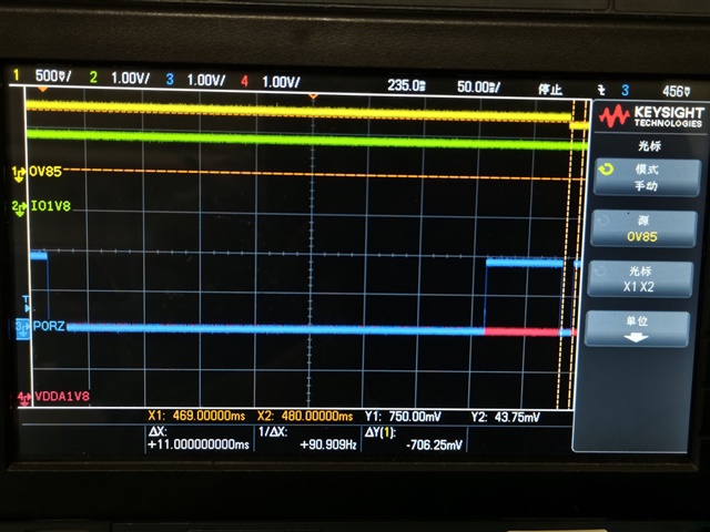

2when it is in abnormal boot status ,  we measure the reset PORZ pin voltage , it is high :3V3 .
and in situation , we put this PORZ  to low and then release it to high .  the SOC is still in this abnormal status .
3,we test the  bootup config pin , its waveform meet our expectation,  good enough .

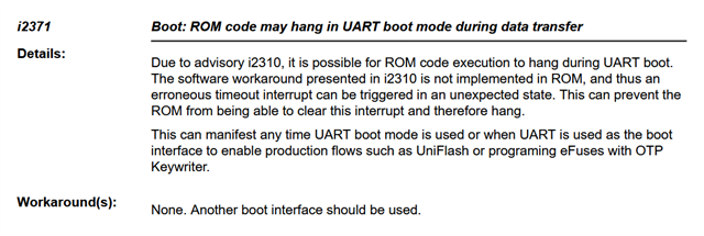

    Is it possible on your board to choose another boot option like e.g. USB to test if it works?
    Unfortunately UART is not a reliable option in this SoC. Please refer to errata:

    Did you have the chance to capture the MCU_PORz with oscilloscope in case of your manual PORz de-assertion ?
    I will analyze your inputs and try to respond by early next week June-15 COB.

  • The root cause from ROM log is the flash was not recognizable.
  • hi Anastas,  Please take the waveform as reference. The first de-assertion is mannually pulled down. The second de-assertion is 10ms.
  • Here is the detail parsed log.
    ROM tries to read the data from flash:
    1st at offset 0x0
    2nd at offset 0x400000
    Then it switches to the backup boot mode which in this case is UART.
    The DER warning shows that the data read from flash was not recognizable.
    Device AM62A rev R10

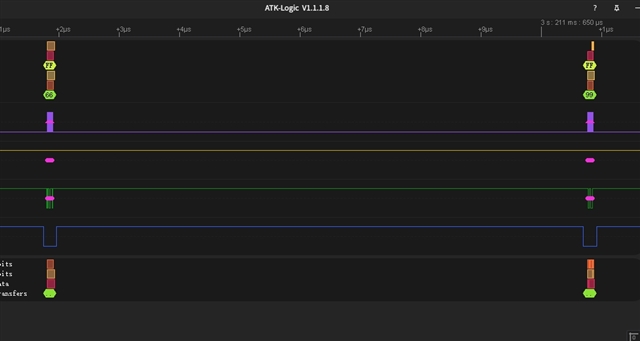

    Can you please try two experiments ?
    1. Send the RESET command to flash (66h + 99h) as described in flash data sheet before issuing PMIC reset.
    2. Set the backup boot mode to NONE. This will cause ROM to retry SPI boot multiple times without waiting for 120s UART timeout. We can get more data points.
    Please copy other team members as required.
    Sreenivasa
  • hi Kallikuppa
    these two experiments were done .
    1, implement the flash reset (66+99) before PMIC reset , It is still in error status with boot fail . attached the data waveform .
    2,Backup boot to NONE ,and implement the flash reset (66+99) before PMIC reset, we get the log . attached .

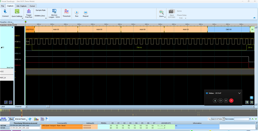

    However, after the system runs and resets, the first four bytes look strange.
    To determine whether the FFEEEEEE value is read from OSPI Flash or not, the full QSPI trace is needed.
    If the data is from nor flash, the next action is to find a solution from the flash view on how to set the status to
    an uninitialized state.
    If the data is from OSPI controller, the OSPI controller also needs to be reset.

  • Hi Dong,
         We performed a failure log analysis today and should be able to explain why the 0x6000_0000 view shows FFEEEEEE. Below is a waveform picture of when the failure occurred. Regarding the ROM reading the flash: the flash is in 4-byte mode, but the ROM is reading it in 3-byte mode. As a result, the OSPI controller will interpret the fourth address byte as dummy data and treat the dummy data as the first words from the flash—although this doesn't perfectly match the observed waveform.
        To fix this issue, ensure the Flash is in 3-byte mode when booting from ROM . My suggestion is to software reset the Flash and close the controller before the PMIC timeout, then wait for the PORZ reset.
      If we encounter any boot-up stability issues, I suggest we analyze them one by one. Thanks.
    Linjun
  •      Thanks a lot for joining the meeting with the flash vendor today. With the captured log analysis, we clarified the following issues:
    1. Following the sequence of reboot and PORZ reset, the system cannot boot up because the Flash is in 4-byte mode.
    2. The previous test sequence—power off the flash, then power on, and PORZ reset—still resulted in reboot failure. The root cause is that the power off doesn't cut off power, so the flash remains in 4-byte mode, causing the startup issue.
      To fix the issue:
          Solution 1: Keep the QSPI FLASH in 3-byte mode permanently. When accessing addresses larger than 128MB, use the 6C command directly in SBL stage 1 and SBL stage 2. @Saxena, Karan—could you please confirm whether the OSPI Interface
      avoids calling the B7 command (enter 4-byte address mode) and instead uses the 6C command (4-byte address read command)?
        Solution 2: Follow the TRM spec and connect the NOR flash reset pin to PORZ.
