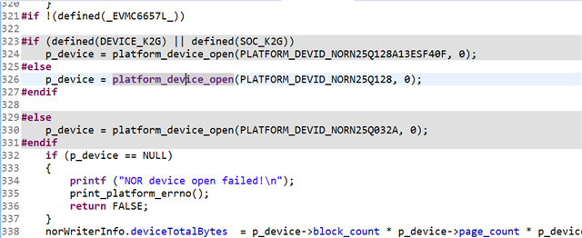

I'm using MT25QU128ABA nor flash device with TMS320C6655. Nor flash is upgraded in remote in Nor boot always. The platform device open fails intermittently. can you suggest a way to troubleshoot the issue?

  • Hi Betsy,
    Nor flash device configuration is done in Platform library and rebuilt. Unfornunately we could not collect logs because this happens when processor is in flash mode(Nor boot mode). But I have seen error no 0x12 sometimes in debug mode. This happens intermittently and not all the time.
    Request you to suggest a way to troubleshoot this issue.

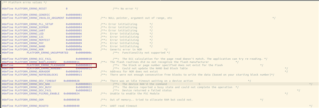

  • Hi Fartine,
    Since platform_device_open() fails intermittently, it suggests a possible device state/timing issue introduced by the upgrade, rather than a library or configuration-related problem.
    While reviewing the platform.h file from the SDK, The error code 0x12 indicates "The block or page number specified does not exist for the Flash".
    Can you verify the descriptor geometry you added for MT25QU128ABA?
    &  If possible, could you please share the changes implemented on your end as well, so that I can cross-check them from my side?
