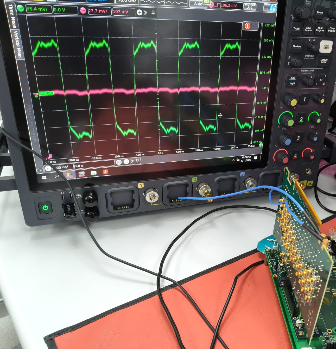

we have recaptured the AM6442 internal PCIe reference clock using a PCIe load board as part of our updated test setup. Following this modification, the measured jitter performance now meets the compliance requirements. We used SMP to SMA cable to to capture the clock signal.
However, we are observing marginal failures in the following signal integrity parameters during compliance validation:
  • Rising edge rate
  • Absolute crossing point voltage
We have attached the latest compliance test report along with detailed images of the measurement setup for your review.
We request your guidance on:
  1. Potential root causes for these marginal deviations
  2. Recommended next steps to mitigate these issues and achieve full compliance
load board.pngPCIe_CLK_Report_2026-06-15_11-36-12_two_fail.pdf IMG-20260615-WA0004.jpg

    I am glad to see the signal looks better when using a compliance board compared to before. My initial thoughts on what you're seeing revolve around the termination of the clock signal. Few initial questions:
    1. Does the board this report was captured on have any external termination resistors present?
    2. This may be a question for the scope manufacturer on your end, but is the input of the scope terminated at 50 ohms or some other value?
    Sincerely,
    Lucas
  • Hi Lucas,
    Thank you for the quick response. Please find my answers to your questions below.
    1. Does the board this report was captured on have any externa termination resistors present?
    Ans: No
    1. This may be a question for the scope manufacturer on your end , but is the input of the scope terminated at 50 ohms or some other value?
    Ans: We are using the SMA to SMP cables with standard termination of 50 ohms at the probing end.
  • Greetings Aditya,
    What about the scope inputs themselves? The scopes I've seen for this type of work usually have their input impedance set to 50 ohms, but some scopes can have a configurable input impedance depending on their complexity.
    Sincerely,
    Lucas
  • Hi Lucas ,
    We had discussion with Keysight team reagrding the scope channel termination. And they confirmed that channel haa a termination of 50 ohms. Attached reply snipshot from Keysight Team.  And let us know how to disable internal terminations in AM6442 for the REFCLK. Kindly let us know how to proceed further.
  • Greetings Aditya,
    That's good to confirm with the scope vendor.
    Under normal circumstances, disabling the internal termination properly has to be done as a specific part of the SERDES initialization. It's possible to do so after initialization as a debug step for the behavior you're seeing, but just to be clear: this method of disabling the internal termination is not meant to done in real operation. Because it's not being done as part of the proper sequence, it's also possible there are other unknown electrical or functional effects to the interface from this debug step, but it should be effective in removing the double termination of the clock signal for your measurement.
    It's important that the REFCLK output has at least one 50ohm termination path to ground at some point in the path not only for proper signaling, but also to avoid causing potential damage to the part. In this specific case the scope you are using is providing that, but on the actual board it's unlikely the endpoint device will provide this path. We cannot debug or provide support for a part that has been potentially damaged by disabling the internal termination with a board that has no termination. Be careful with testing the below register sequence and ensure whatever platform is being tested is properly set up.
    You should be able to disable the termination like so on AM64x specifically for this debug:
    • Clear bit 31 of 0x0F00040C
    • Set bit 27 of 0x0F00040C
    • Set bit 31 of 0x0F00040C
    • Clear bit 5 of 0x0F0000A0
    Again, all caveats/warnings above apply.
    Sincerely,
    Lucas
