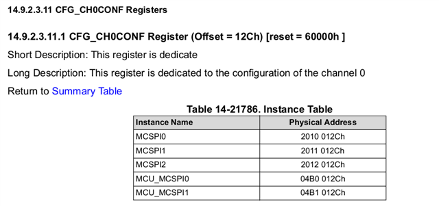

  • HI,
    What is the value of this register with and without the ti,pindir-d0-out-d1-in flag for you?
  • this is without ti,pindir-d0-out-d1-in;
    devmem2 0x2010012C w /dev/mem opened. Memory mapped at address 0xffffb8bf8000. Read at address 0x2010012C (0xffffb8bf812c): 0x20012444
    this is with ti,pindir-d0-out-d1-in;
    devmem2 0x2010012C w /dev/mem opened. Memory mapped at address 0xffffaa7eb000. Read at address 0x2010012C (0xffffaa7eb12c): 0x20062444
  • Hi Sajid,
    Thanks. The registers look correct, let me try replicating the issue at my end. Will respond by end of this week.
  • Hi Sajid,
    I tried the same at my end and it works atleast with the 4-wire configuration. Are you trying to use the 3-wire configuration?

    Register value at address 0x20100128 = 0x00000001 (Can you share this register value as well?)
    Yes, I am using the 3-wire (9-bit SPI) configuration.
    My LCD is E24RG12432LWIM800-C, which uses the ST7789V controller. The Linux driver for this panel is: https://github.com/torvalds/linux/blob/master/drivers/gpu/drm/panel/panel-sitronix-st7789v.c
    value of register address 0x20100128 with or without  ti,pindir-d0-out-d1-in;
    is same.
