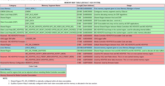

  • You need to change the following file
    $(C6ACCEL_INSTALL_DIR)/soc/packages/ti/c6accel_unitservers/TI816X/serverplatforms.xs
    with new information in EZSDK 5.03.
    See this spreadsheet 6305.EZSDK_MemCfg.xls  from the wiki for more help.
    After that, loadmodules.sh should be updated as well.

  • This for the codec engine examples to run with video firmware running. For c6accel, modifying
    might help. I made these changes(shown in red text below) to get updated memory map for TI814x 1GB (not the TI816x) platform in
    $(CODEC_ENGINE_PATH)/examples/ti/sdo/ce/examples/servers/all_codecs/package.bld,
    per the wiki, thus:

    The changes were made per this link: http://processors.wiki.ti.com/index.php/Codec_Engine_Server_Integrator_User's_Guide#Platform_Memory_Map_Configuration_.28BIOS6.29
    cmem load script must be updated per this link:
    http:/processors.wiki.ti.com/index.php/HOWTO_Change_the_Linux_Kernel_Start_Address#Updating_CMEM_Memory_Region"> http:/processors.wiki.ti.com/index.php/HOWTO_Change_the_Linux_Kernel_Start_Address#Updating_CMEM_Memory_Region">http://processors.wiki.ti.com/index.php/HOWTO_Change_the_Linux_Kernel_Start_Address#Updating_CMEM_Memory_Region
    In my case for  1GB TI814x EVM with 5.03 EZSDK cmem's  phys_start=0x96C00000 phys_end=0x97ffffff
    I am still working on this. Will let you know if this works.

  • RV,
    Don`t you think your CMEM and DDR3_DSP regions are overlapping. I think you need to change your DDR3_DSP configuration to start at 0x99500000 as specified by the Memory map on that wiki.
    Rahul
  • I am confused on how the spreadsheet helps. Is the idea to type in some number for DSP_CODE to something other than 0 and then use the table of offsets ??
    Why can't anyone just say . if you want to use the DSP set value N to amount X and use the recalculated numbers. A simple example of how to get there from here is really needed.
    Tony M.
