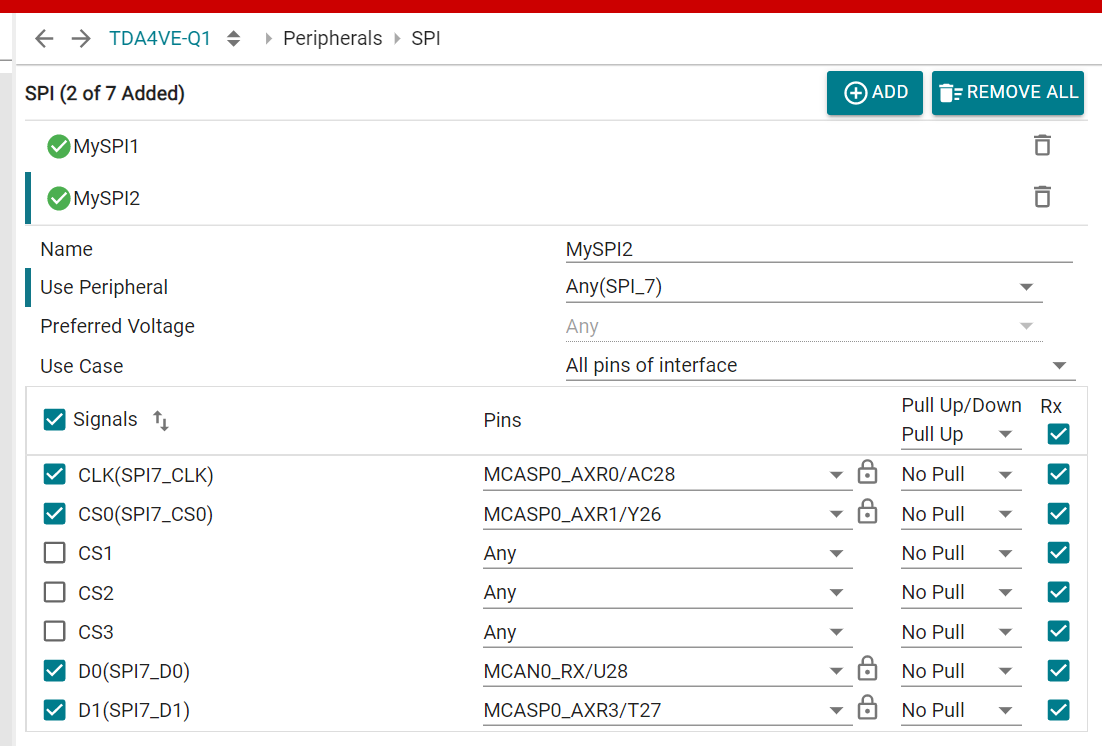

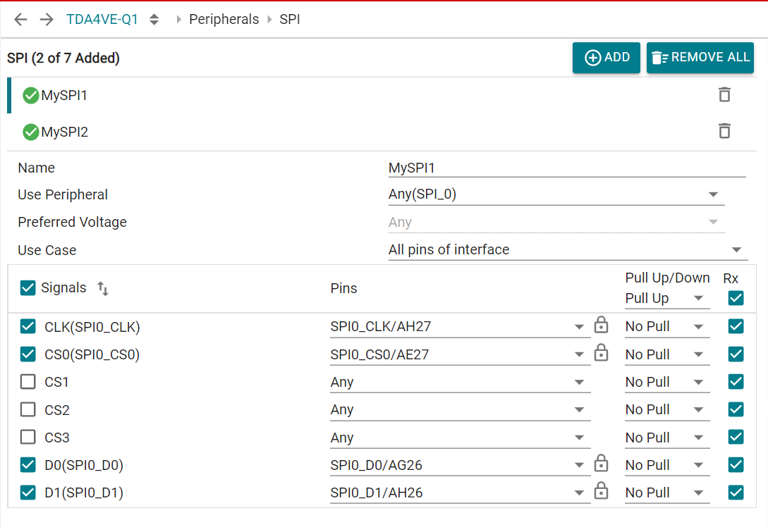

Hi Ti experts,
Does the following configuration satisfy the IOSET restrictions?
Since SysConfig doesn't show any information regarding IOSETs, where else can I find reference materials for IOSET besides SysConfig?
1.
2.
Thanks a lot!!
Alice
  • Hi Alice,
    SPI0 through SPI7 instances in the MAIN domain do not have multiple pinmuxing configurations; thus, there is no need to consider IOSET for them.
    In case you are using MCU_SPI0 or MCU_SPI1, the IOSET information can be found in the TDA4VE-Q1 datasheet. The tables are named MCU_SPI0 IOSETs and MCU_SPI1 IOSET.
